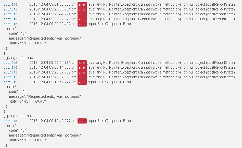

Google Home is throwing these errors a couple times per minute:
What should I do?

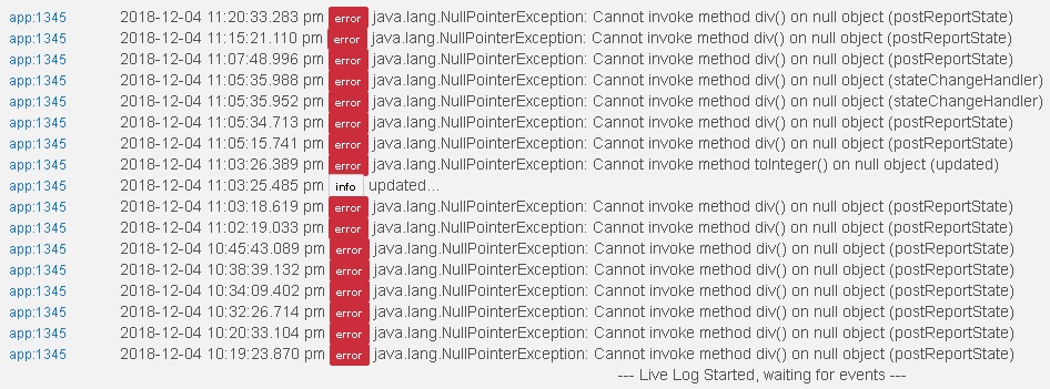

Rebooted. It s̶t̶o̶p̶p̶e̶d̶ ̶ slowed down a little, but still happening.
I had a bunch of these, then I removed some devices and added some new ones and it shrunk down to 1 entry like that coming in. It is still there as well for me. Have a ticket in with a Thermostat issue as well.

Any tips on deciphering which device it is?
Wow no. I made a lot of changes to my setup (Christmas) and I deleted and re-added a lot of devices...
Sorry...
Other than starting over I don't know what to say. I have a feeling the driver will get to a more stable version as these issues are pouring in and get fixed. But until then a purge might be best...

I'm getting the errors described above as well as this:
app:9932018-12-07 06:09:15.340 pm errorsyncResponse Error: {
  "error": {
    "code": 403,
    "message": "The caller does not have permission",
    "status": "PERMISSION_DENIED"
, giving up for now
