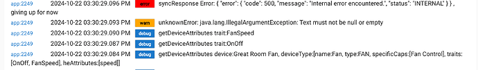

I just went through and added several devices one at a time got a good portion of my setup back. When I added a Fan devices I got these errors. App 2249 is Google Home

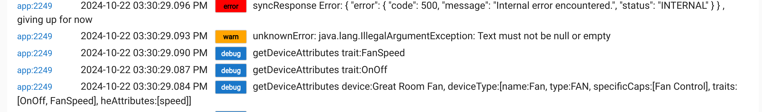

This caused me to consider testing my fan Driver for a Govee Tower fan I have. It generated this error.

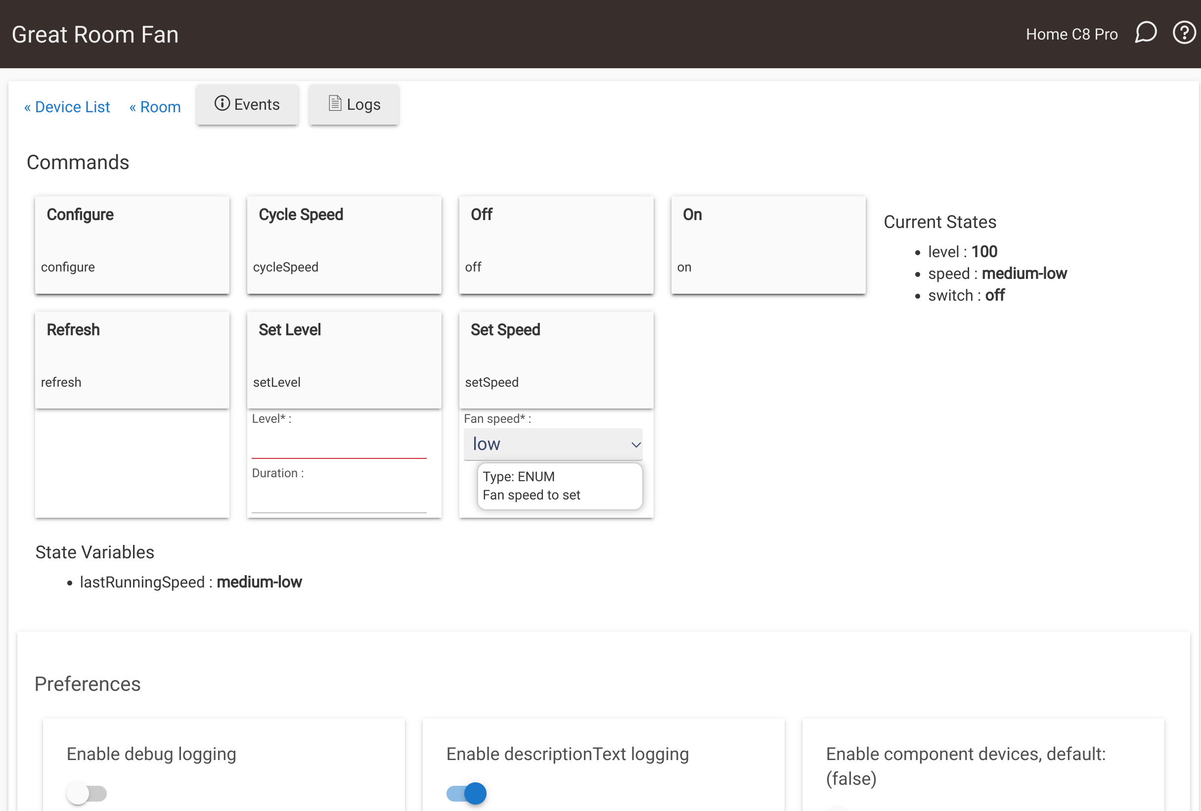

They should work, can you send me a screen shot of the current states shown in the driver details?
That is the Zigbee Hampton Bay controller with built in Driver.
Here is the error with debug logging turned on. I see the debug and warn messages a few times through the log and then eventually eventually get the error message
the driver is missing the supportedFanSpeeds attribute, I'll add that into the next build, it will update once you click configure in the next platform version
