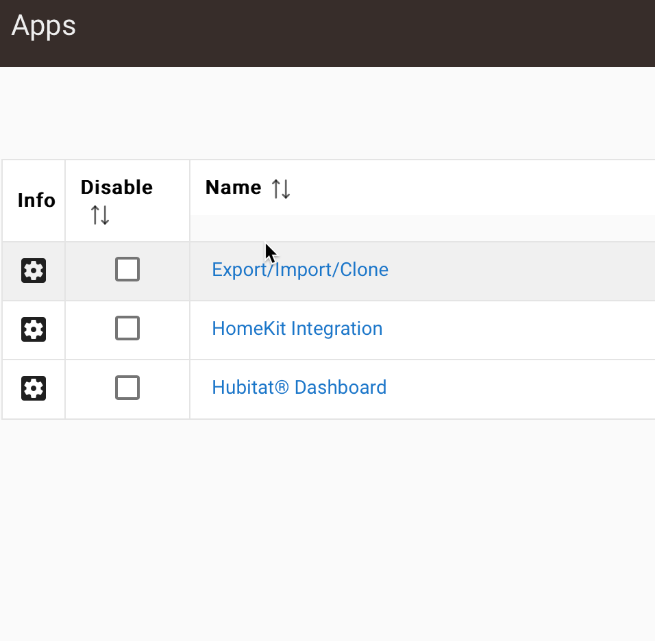

I've attached the screen shot of my apps. I don't see Google Home there and if I add apps I only see the instructions for installing app.

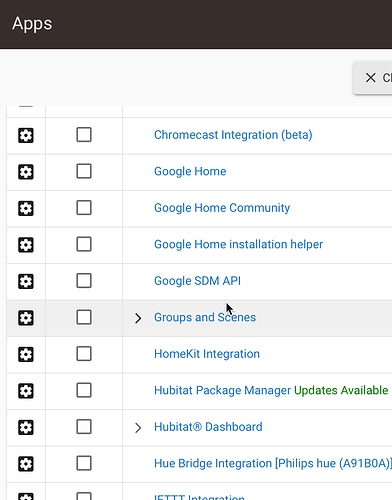

Replying to myself here. That app list didn't look right to me. As I mentioned this all started when I tried to restore from a backup after my C8 became unresponsive. I know I had more apps installed than that so I went back another week and restored from there.
Now I have a complete list of apps that I remember having before and Google Home app is in the list. I still am not able to get the list of devices back after step 6. I assume I should delete the app in Hubitat though and try again? I will wait to hear back on how I might proceed so I don't bork anything.

So I decided to not wait because I could always restore again. I went ahead and removed the GH app from HE. I was then able to proceed to step 7 from step 6.

Seems like possibly you just had a search filter set on the apps page, it happens to people all the time and they think the apps or devices are gone. Restoring the older backup may have cleared that.
So I am guessing that you did still have the GH app on HE, but could not see it due to a search filter. Or possibly something in the DB was corrupted causing the apps list to not fully show, but the GH app was still installed and not visible.
Not really sure how all your apps except 3 would just suddenly be missing?
