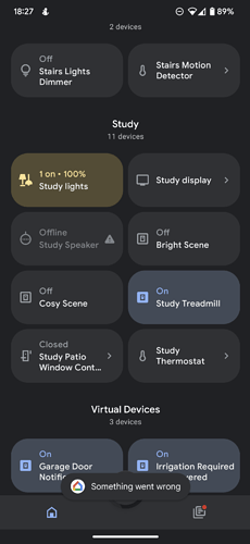

I recently had to rebuild my zigbee network and Im now unable to add all the outlets which were repaired again as part of this to GH. It looks like they were never removed in GH after removing them in the GHC app. When I try to switch any of them I just get a "An Error has Occurred" toast message in the GH app.

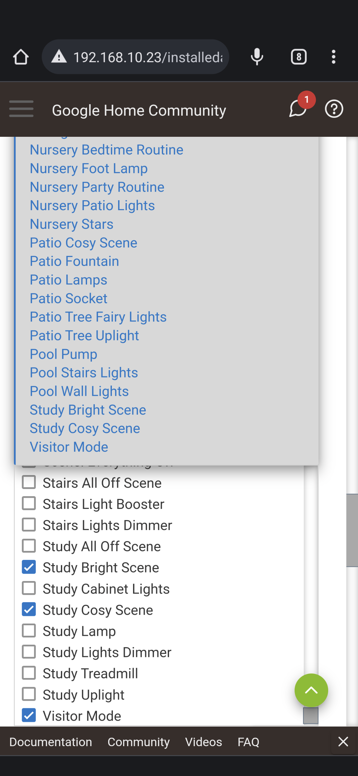

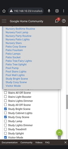

As you can see from these pics, the study treadmill device isn't linked in the app but still appears in GH, and gives the toast error when trying to access it.
