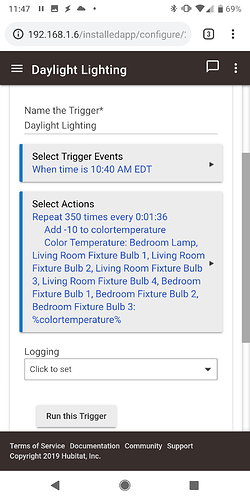

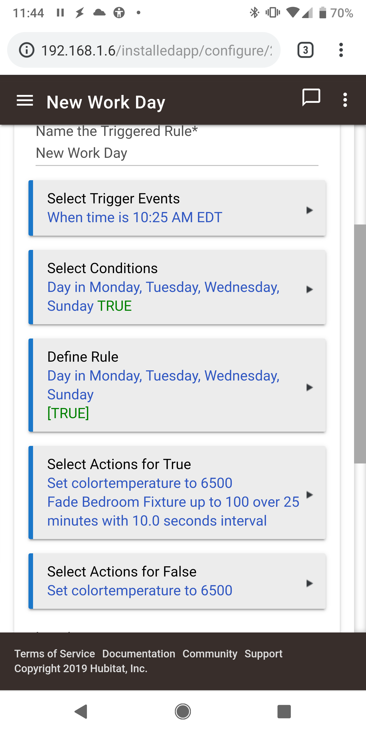

I noticed this morning that my good morning triggered rule didn't run, nor did my trigger that changes the color temperature throughout the day.
Triggers are shown above, I also noticed I was disconnected from the cloud, but that shouldn't matter, right? No evidence my hub was down in general, as other calls were made in that same hour in the logs, first rule is set to log everything, second doesn't log because it's chatty. Logs are totally blank wrt this triggered rule for that time period. I was on the previous update 2.1.0.123 just updated to 2.1.1.124 today. Help is appreciated.

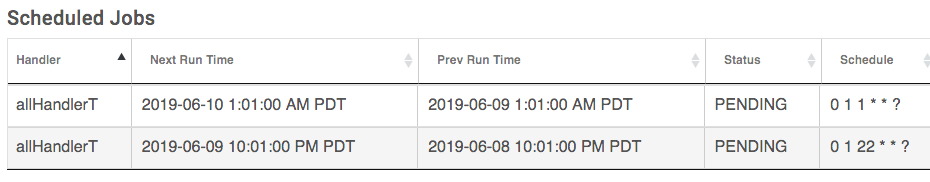

It shouldn't have, but I'm wondering about it. Perhaps the DB had a tiny corrupt going into the upgrade and it got cured by rolling back... to 'yesterday' -- which would have been before today was scheduled. It's a very wild guess, but you should be able too look in Scheduled Jobs (Rule, gear, scroll to the bottom) and verify that tomorrow is scheduled.

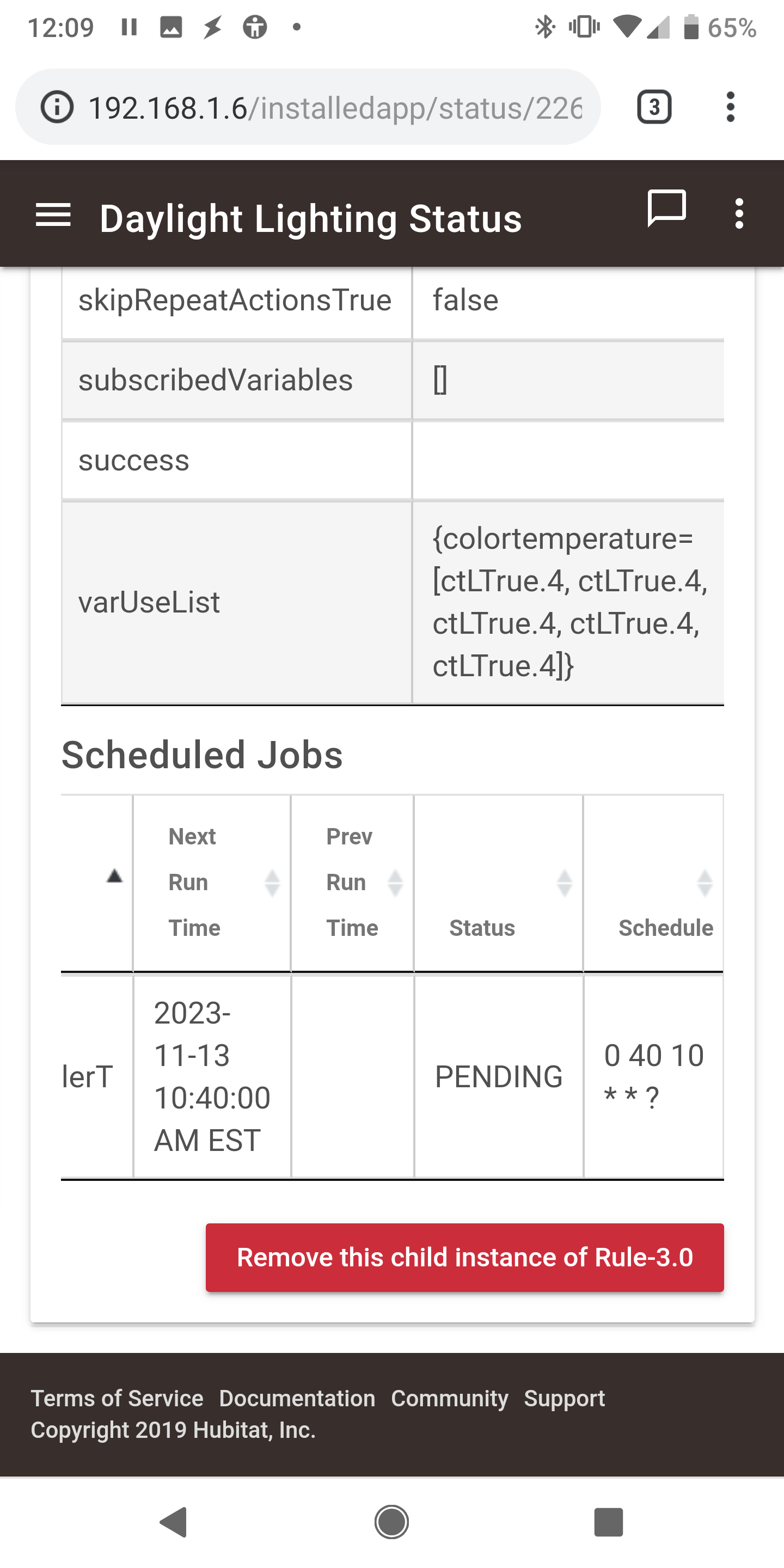

Scheduled jobs for both rules very sketchy,
According to this my daylight lighting trigger has never ran, which is definitely wrong, and won't run again until 2023, lol. New work day has the same date on it, although it says it ran last on Friday it's possible it didn't run Saturday, I wasn't home at all

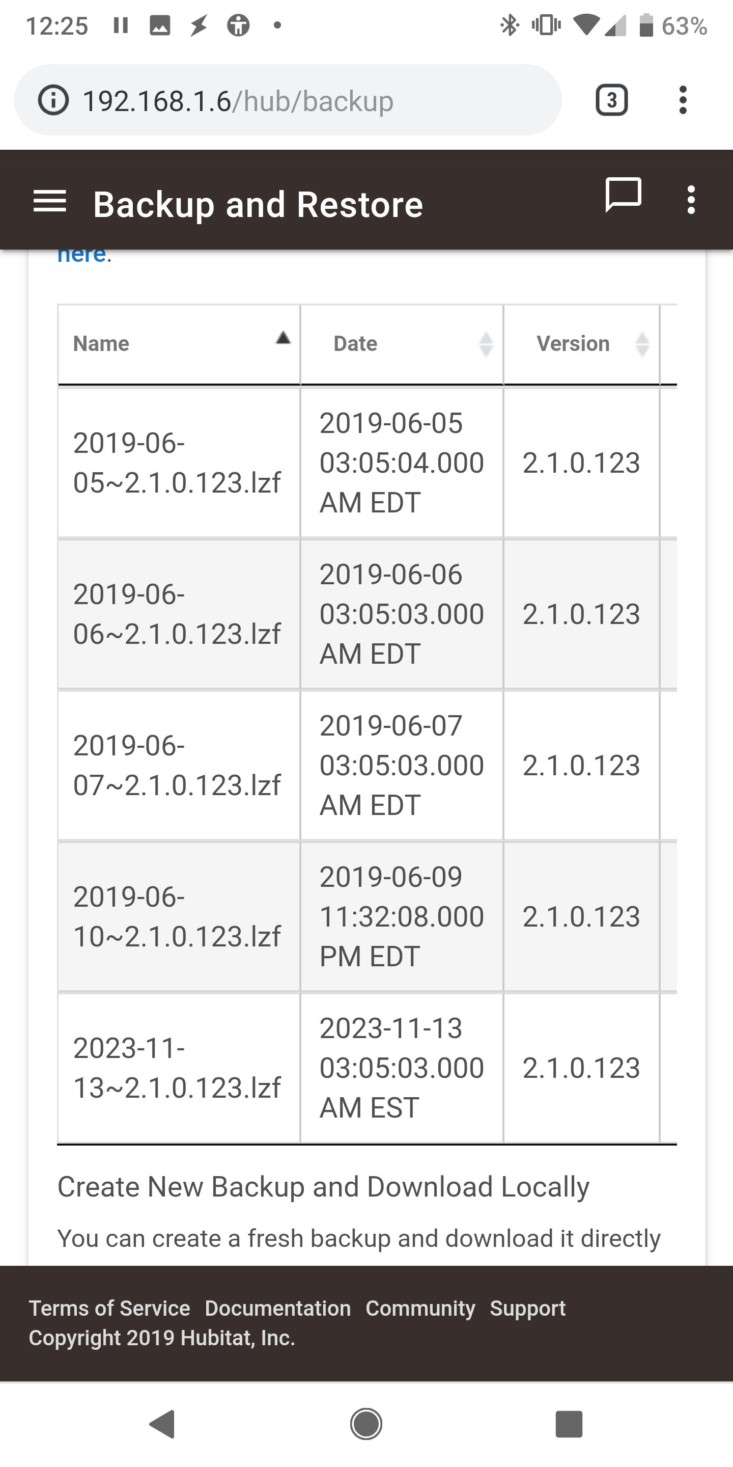

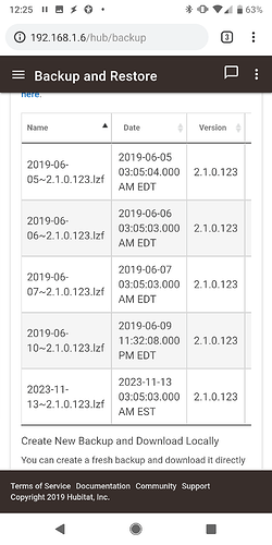

The plot has thickened, also I went to restore a backup to see of that would resolve the issue and found that there is a backup from the future
Didn't end up restoring because I'm not sure when exactly the issue arose now. Only logical explanation is that my hub traveled through time.
Restoring to 06/07 fixed the issue, still not sure exactly what happened.
