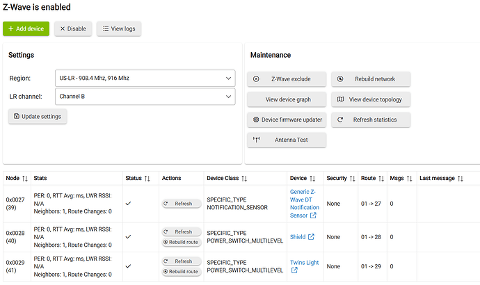

How do I switch to Z-WaveJS? Here is what I see on ZWave settings page. Top device is ghost.
What platform version is your C-8 Pro running? I am asking because the Z-Wave details page suggests you have a C-8. Or, it is a C-8 Pro with a very very old platform version (pre-ZWaveJS).
The fact that the antenna test shows up indicates it is a recent platform version. Are you sure your hardware is a C-8 Pro, because from the Z-Wave details page it appears to be a C-8. Switching to ZWaveJS via the hub GUI is an option that is restricted to C-8 Pro hubs.
Looks like just C-8

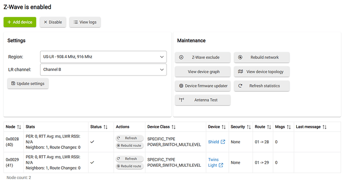

I just clicked “Remove”, disabled zwave2 and rebooted. Ghost is gone. I still cannot exclude/include the GoControl. Any ideas?
Can you post your z-wave details page in it’s entirety? Use windows snip
that's not enough devices to reach the garage reliably most likely from the hub. you need more of a mesh with every 30-40 feet or so a device that can be a repeater
