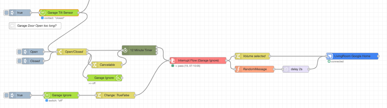

I have the same setup... the Linear GD00Z-4 GDO was spitting false events all the time. I switched my automation Alerts to only use the Ecolink. I have a Node-Red flow that says "The Garage Door has been Open too Long." Every 90 seconds after it's been open 12 minutes. All driven by the Ecolink, not the GDO. I have the GDO in a Dashboard so I can get a confirmation that way, but for everything else, I use only the ZWave Plus Ecolink Tilt Sensor.

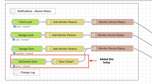

Almost exactly the same setup (including Node-RED). My flow checks every 10 minutes (max 5 times) using a delay node. The "delay" node is cancelled if a "closed" event is received. What I just did, was add the GDO to the flow (filter for only a "closed" event) so that either "closed" event will cancel the delay and not send an alert.

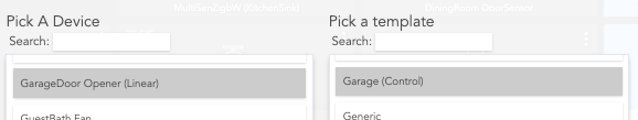

My Dashboard item:
Screen Shot 2021-08-19 at 7.12.54 AM

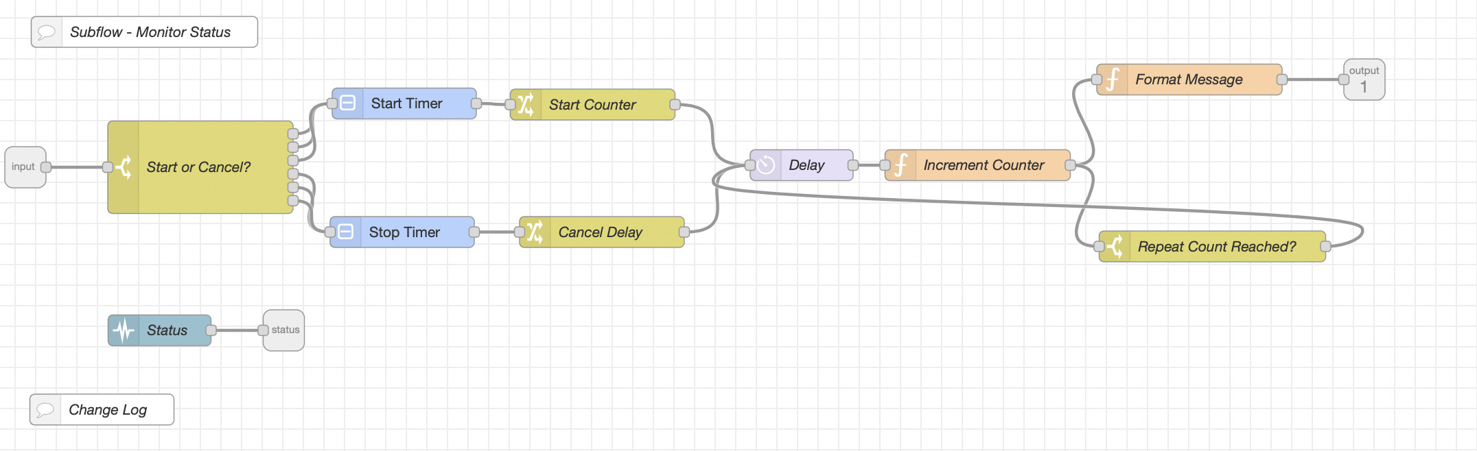

Nice - mine is similar but I use a subflow for monitoring status as I can use that across multiple devices.
The subflow:

I added the Virtual Switch"Garage Ignore" for those occasions when we know that the GDO will be open for more than 12 mins. Kids skating with their friends and using the Garage as shade, or gardening are the most common examples. Then I don't want the noise of the alert. When the GDO does close though, that override is reset.
