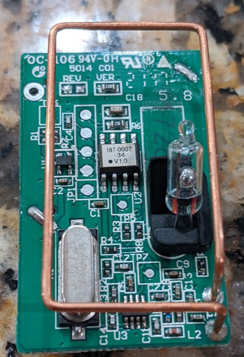

I've seen some issues where the ball gets stuck in the tilt switch inside the device sometimes if it gets really cold. You can pickup a pack of mercury switches for about 7 bucks including shipping and replace the little ball sensor.
https://www.ebay.com/i/383674066987?ul_noapp=true
This isn't the same part but I did it for both my GDZ tilt sensor and an Ecolink tilt sensor. The picture is the Ecolink.
