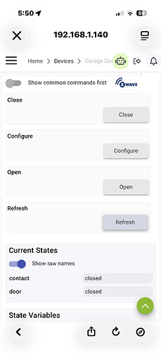

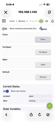

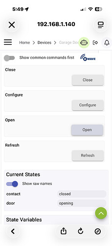

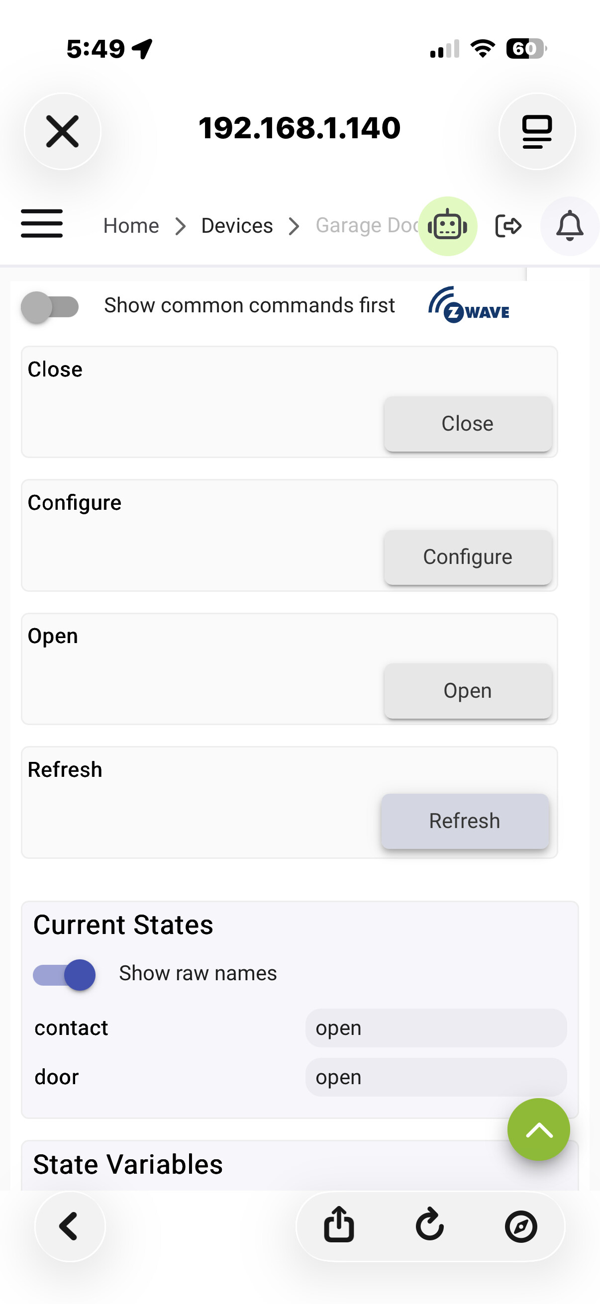

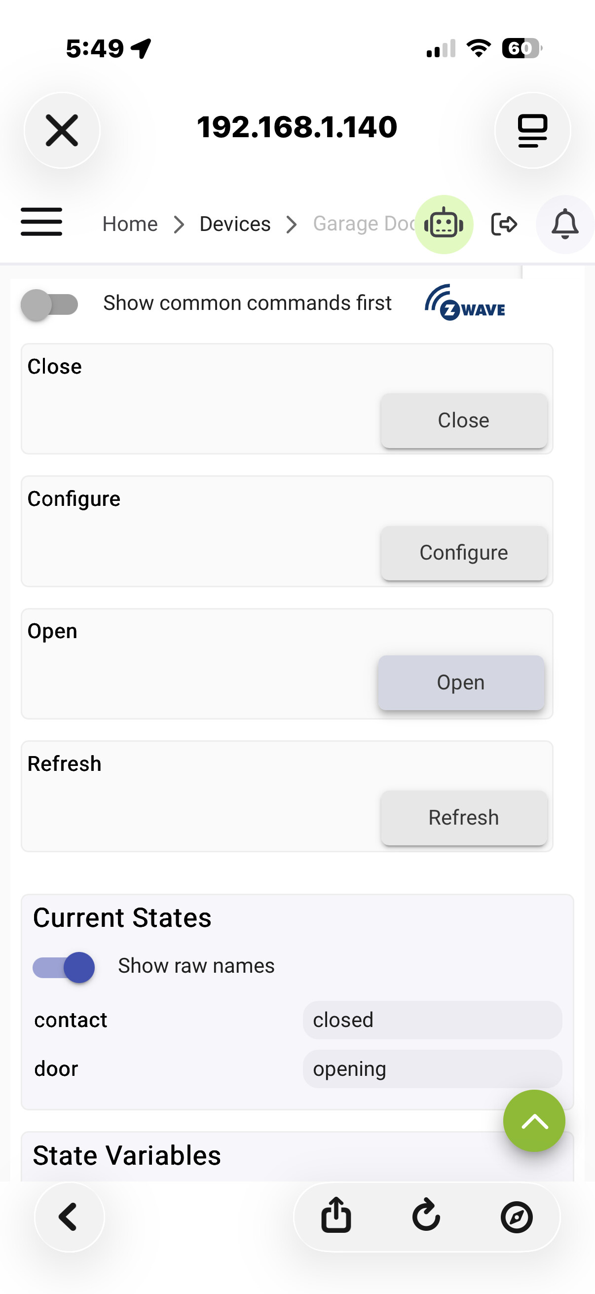

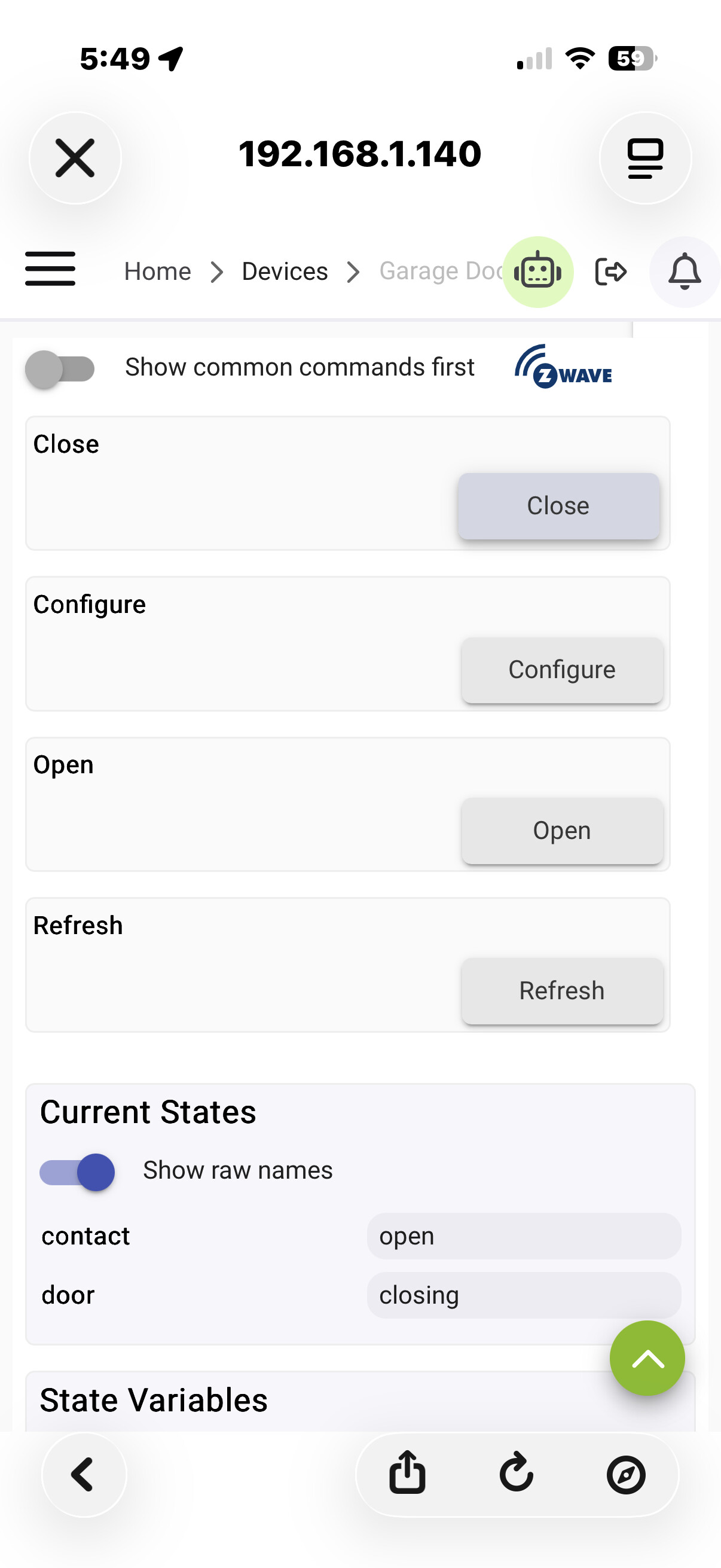

My GoControl Garage door controller is not reporting open/close since the latest firmware update. It will show opening or closing. It will only show close or open once I hit refresh. So now my notifications or rules to close the door don’t run
I have a C8 pro running zwave-is

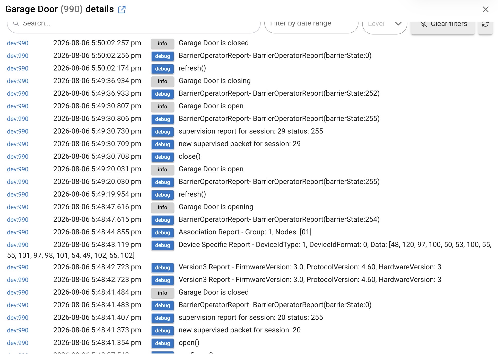

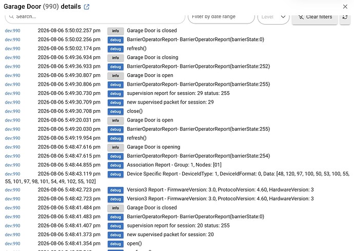

Can you turn on debug mode and grab the logs from an open/closed event?
Ok.. That didn't help...
Can you do this:
http://<your-hub-ip>/hub/zwave2/ccdebug/true
Then do the same open / close tests and then PM me your hub id..
This will produce a detailed backend log of the z-wave activity during that time
Once finished you can:
http://<your-hub-ip>/hub/zwave2/ccdebug/false
