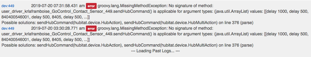

I am receiving the following error in my log on my GoControl Contact sensors. They appear to be working but I was wondering is anybody else is seeing this?

Update: The fix is actually really simple, just replace return sendResponse(cmds) around line 353 with return response(cmds)

I realized how easy it was to fix that error so I added it to one of my posts a while ago.
Replace the line below, which is around line 353:
With:
You'd only see that error when the device wakes up which I think happens about every 12 hours...
