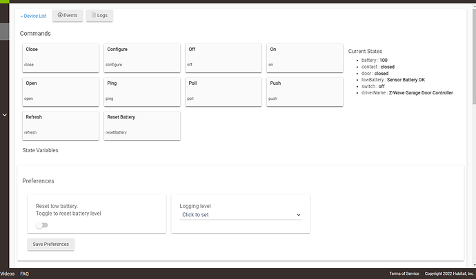

Try using the custom driver by @lewis.heidrick, below is my device page using his excellent driver.
You will have to search Garage door (below screenshot) in Hubitat Package Manager, install it, change to the new driver and hit configure.
Hope this helps, -Joel
