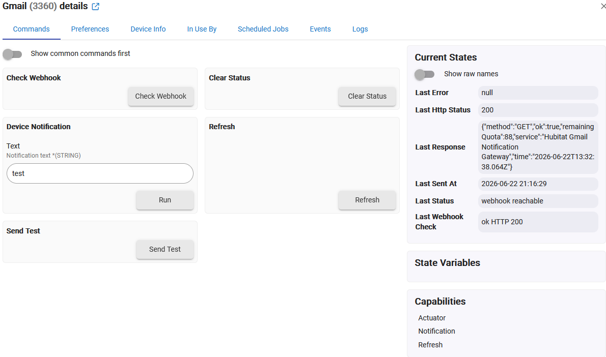

Hi all,
Hopefully some reuse for the community;
This allows Hubitat to send email notifications through a notification device using a Google Apps Script webhook / HTTP POST.
I built this as a free alternative for people who do not want to rely on paid messaging services such as SendGrid, Mailgun or SMTP relays just to send basic Hubitat email alerts.
It uses Gmail via Google Apps Script, with recipient groups controlled in the script and a shared token between Hubitat and the webhook.
Note: Google Apps Script limits consumer Gmail accounts to 100 recipients per day. That means one alert sent to 3 recipients counts as 3, not 1. For most home automation alerting, that should still be plenty if the rules are not too noisy.
GitHub link below and full noddyguide in the readme.
I believe that one can always register a secondary 'Alternate Gmail Account' specifically for Home Automation alerts if they feel that their personal gmail account might exceed the 100 recipients per day limit.

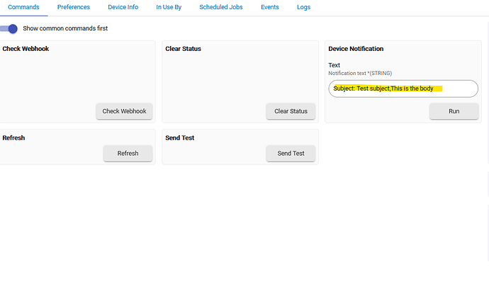

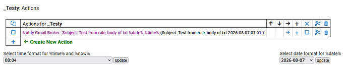

I'd make this suggestion for your version, too:

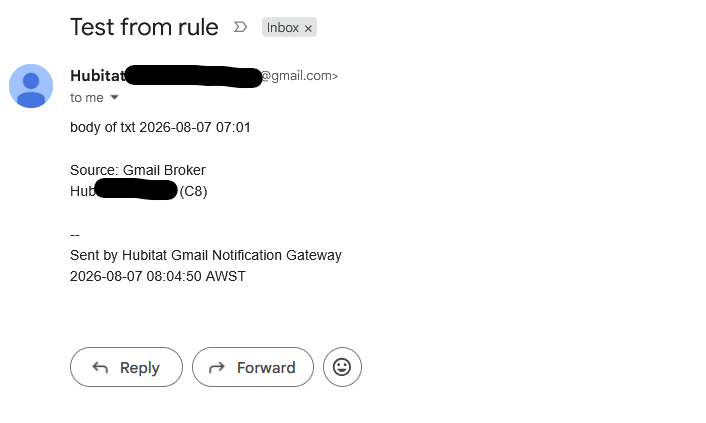

Thanks, sorted - see screenshots below.

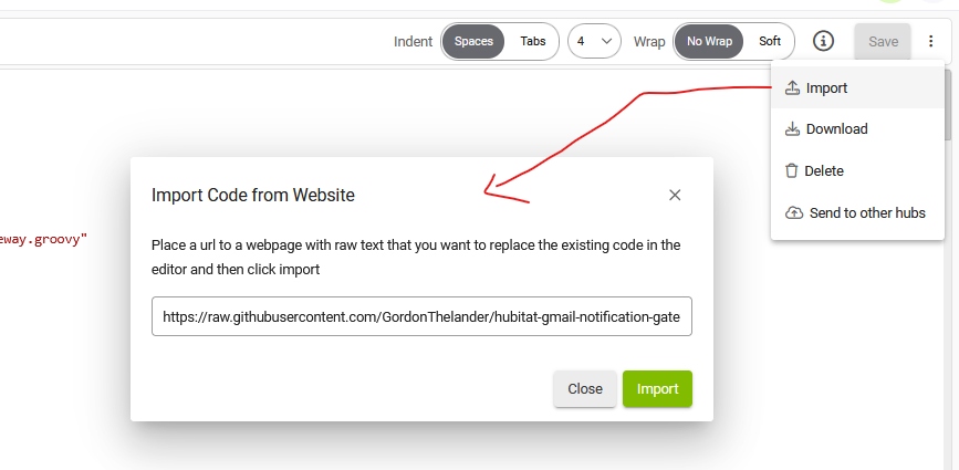

https://raw.githubusercontent.com/GordonThelander/hubitat-gmail-notification-gateway/main/Gmail_Notification_Gateway.groovy
I have also added an import path to the driver, will work post installation of the new code linked above.
