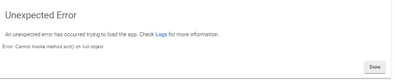

Moving some rules over to the new global variable connectors and experienced an error.
I don't know exactly what I did, so this might be tough. Best I have is I was creating several new global variables. And I think I started typing a new one before the last one had finished updating. I had managed to type in a "V" before the page switched back to the main global variable page. I went back in to create a new variable, the "V" was still there, and I finished creating it. No issues. After finishing creating the variables, I started creating connectors. When I hit this one "VolumeTTS Bathroom Night" (which may or may not have been the one I initially incorrectly entered as just "V") the error occurred.
I'm on a slightly older version, but I don't see that the new versions corrected this error. I am on 2.1.4.126

Errors when trying to enter global variables:
OR, just thought of another thing I did that might have caused it:
I started creating a global variable, lets say it was "Volume TTS Bathroom Night", then the page updated to choosing the type. I noticed it wasn't the name I wanted, and I deleted the space between "Volume" and "TTS" and continued on. It appeared OK, but maybe it didn't like that it had already moved on once with the wrong name, then I went back and changed it.
I'd test if that causes it, but I'll have to restore a backup as I can't see how to get past the "Unexpected Error" into the GV page.
Yeah, I suspect you broke it. I'll have to remove the ability to do that...
LOL, remove the ability to break it?
Thanks for the quick response! I had just gotten started, so no big deal. Will restore from backup and apply the latest hotfixes. And I won't do that again!
