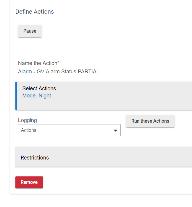

I have an alarm system that I've integrated into HE (it's different to normal panels and doesnt integrate via HSM etc). It has four statuses (armed, off, away, arming). I have used WATO to monitor the status of the alarm system. The alarm system controls all my HE modes.
When alarm = armed, then mode = away etc.
Yesterday, these errors started appearing when the alarm status changed, and as far as I can tell, it's not WATO, because the error is coming from the RM3.0 rule that is called by WATO when the alarm status changes.
This is the WATO
This is the rule called by the WATO, that has the error
For some of the status changes, the mode DOES change (when WATO calls an action, not a rule). But when WATO calls a rule, the mode does not change, that is the rule fails to run. In both cases, rules and actions, there is an error in the logs.
Here are the errors in the logs. I turned on the alarm to stay, which successfully changed the HE mode to night. But errrors.

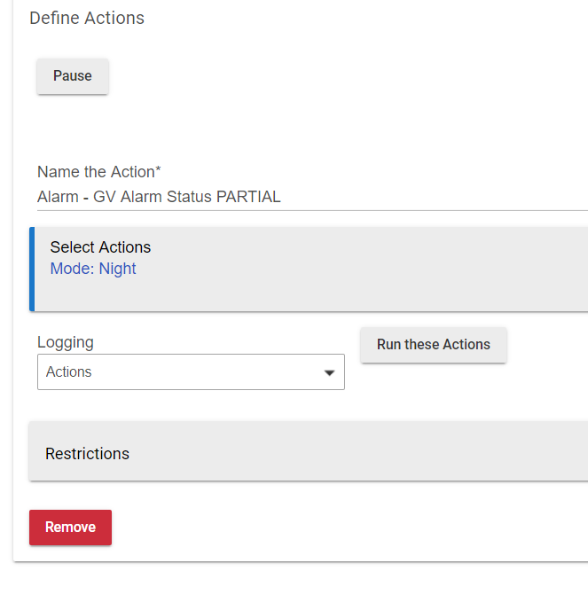

Does this work if you just click on Run These Actions in the RM UI?
Yes and no, and no.
Yes, like above, actions work and the mode changes. But no, the rules and triggerred rules fail.
And No, in all cases there are different errors to previously listed above. These errors are bypassing WATO.
OK, you've only showed the one rule that is an Action, so I have no idea what you're talking about.
These are all RM3.0 rules. I am simply hitting "run these actions" or "run this trigger"
This trigger did change the mode, but produced an error.
Error here:
This trigger did not change the mode, and produced the error (the error comes from this rule).
This action did change the mode, and produced an error
If you want me to find out what's going on I need you to simplify the information you are showing. In any rule that is throwing an error, turn on all logging, so we can see where in the process the error is arising. The error messages themselves carry no useful information.
