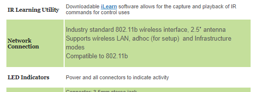

As for the spec, it's right on the product site... (404 Error)
Screenshot 2021-04-09 165721
Yes but it apparently isn't true 802.11b and modern routers that do 802.11AC, etc apparently have issues talking to it. I did see a support article on one of the Global Cache forums that showed you how to "dumb down" a Ubiquiti Unifi config to talk to it. I couldn't find any setting to do similar to the Ubiquiti Amplifi, Apple Airport Extreme or Apple Airport Express.Believe me I wanted the Wifi version to work since it will be across the room from where my wired wall plate is. I will probably have to run another cat6 through the attic. After spending a great deal of time troubleshooting I was really bummed out that it wouldn't work. I look forward to getting the ethernet version so that I can setup your app and give it a whirl.
