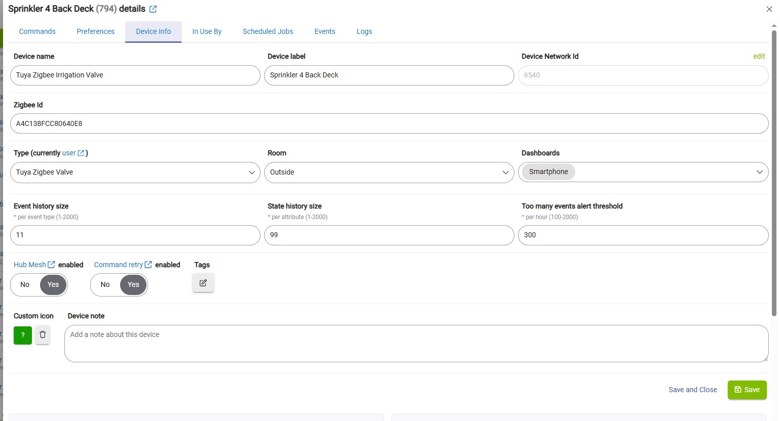

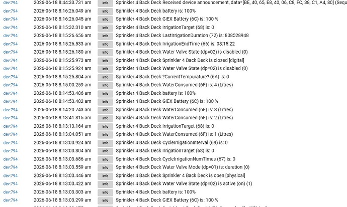

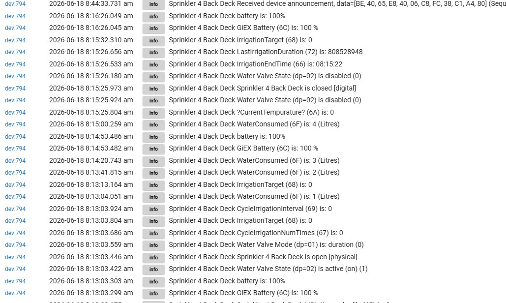

Does anybody use Giex Valves ? I have an issue with reading the logs. Hub C8, Sprinkler 4 was open this morning but the log looks confusing with the disabled commands. Sprinkler 4 is the closest to the hub and it didn't open with a few test runs yesterday, but it looks like it was open this morning. The Auto Off timer and Irrigation Capacity shut off don't work, but I guess this valves don't support that feature. I’m confused where it says “Valve state is disabled”

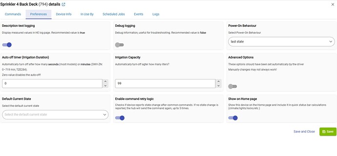

I haven’t tried the volume-based shutoff on these, but the time-based shutoffs work just fine. Use the “Auto off timer (Irrigation Duration)” parameter on the Preferences page for the device, with the time in seconds.

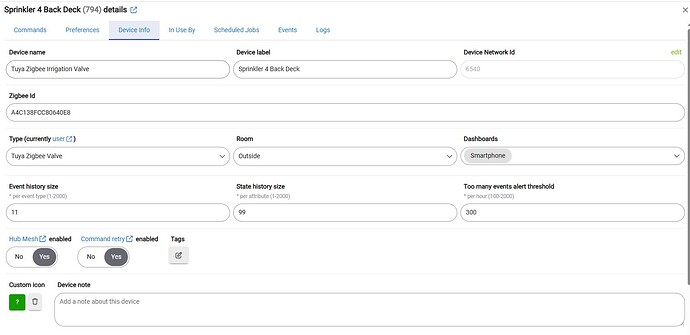

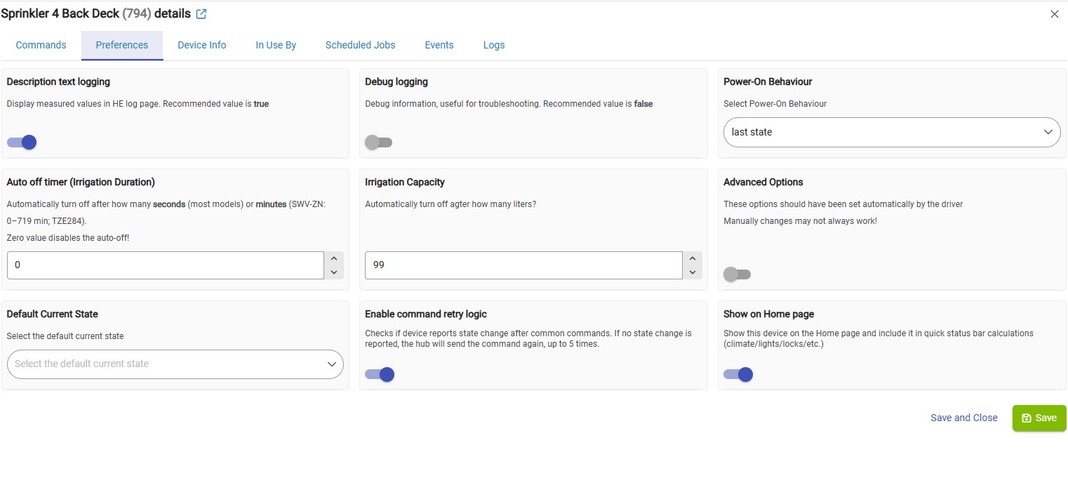

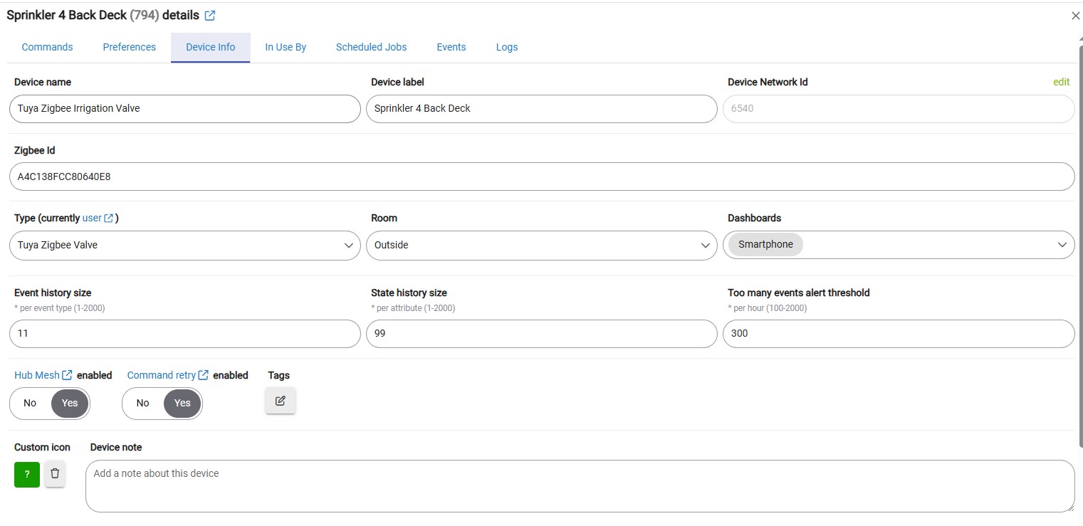

Change your driver to "device" and click get info button, post the fingerprint here so we can check if it's found in the driver by @kkossev
Probably not necessary. As I said (and a couple other people as well), the giex gx-02 works just fine with the driver already.
My thinking was, as with many veried revisions of Tuya chips, his valve might be slightly distinct.

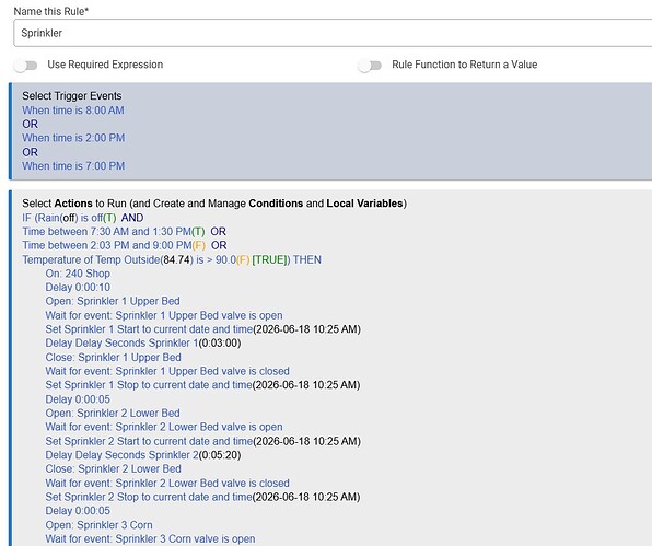

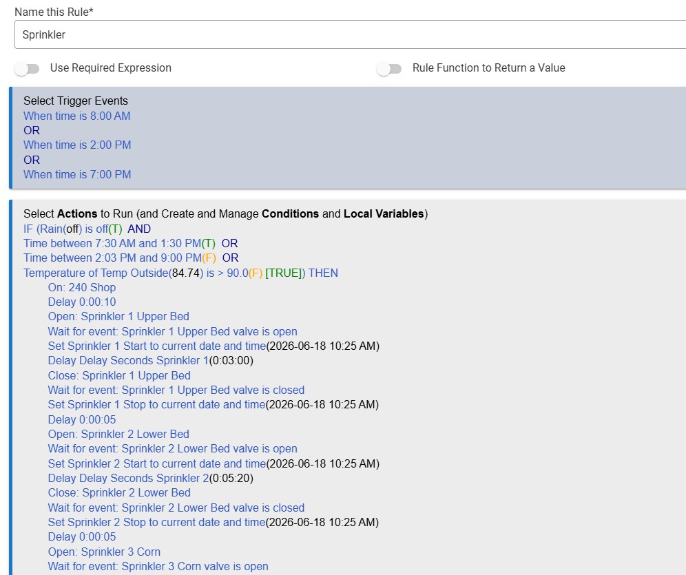

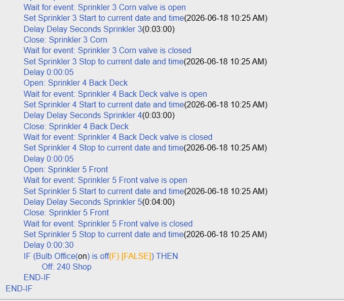

It's possible to do it in RM too. I have the same rain gauge setup and track rain amounts for the last day, week, month and year within RM then display these values on a Dashboard.
