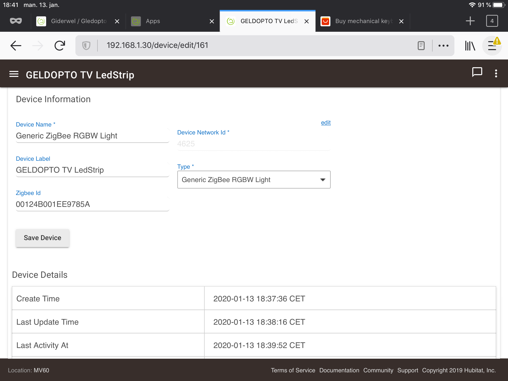

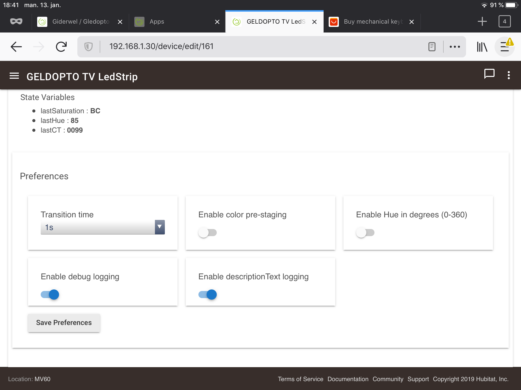

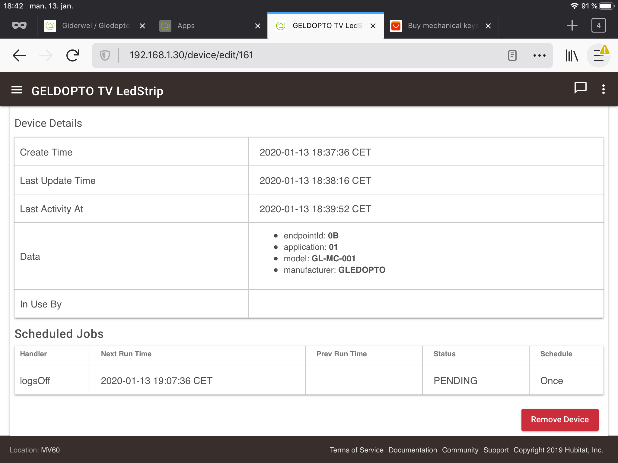

Great news, it worked like a charm!!!
Just set the HE in Zigbee discover, plug in the USB power, and thats it.
Found and recognized it without a glitch. Here is the result of what HE did automatically, and it works on all channels. Set the temp to 6500K and only the white lits up. Looking good to me so far!
Hope this helps out with a few questions for you all?
This is just a quick connection test, no usage of it yet. Have to tape it behind the TV first, then get some feeling with it. Colors worked too, by the way, and turned off the white channel when it went into color mode. :slight_smile:
