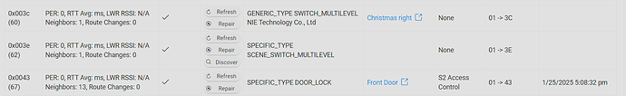

I installed a Ultraloq door lock and ended up with a couple of Ghosts.. I successfully removed them but I see another what I assume is a ghost.. #62
Is it? Thanks in advance
@user1628 Yes 62 is a ghost. Needs to be removed.
be sure to power down the lock before trying to remove the ghost
Thanks all
Removed the other ghost and this one was easier
