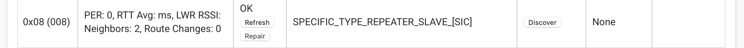

I have an old Zwave repeater that I want to get out of my hub. Is there a way to force remove it? The device is long gone, but still listed ion my zwave report.
Have you tried pressing the “Refresh” button? After a few presses, a “Remove” button should appear if the device is not visible to the Z-Wave radio.
I've been able to get rid of stubborn ghosts in the past by doing a shutdown (with power off). When it comes back up the remove button shows up.
done! Worked great, thanks!
