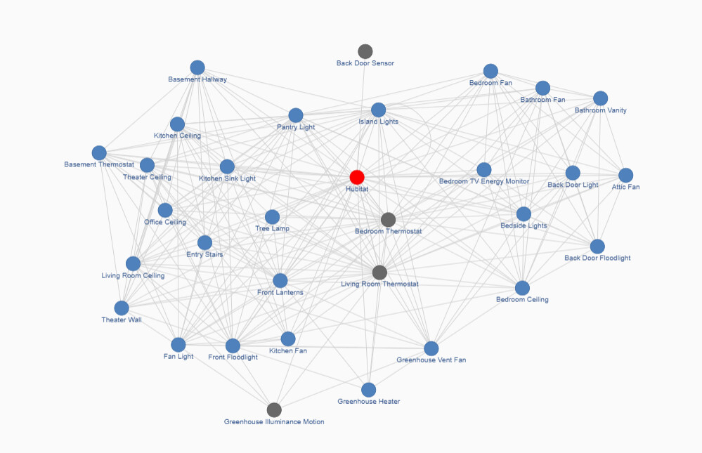

I have a C-8 hub in an A/V closet about 25 feet from my front door. Just inside my front door I have a Zooz ZEN72 800LR dimmer (Porch Light Switch). About 35 feet outside my front door, I have a Zooz ZSE41 800LR Open/Close sensor on my mailbox. I've tried including the ZSE41 in LR mode and I've included it in non-LR mode near the hub. In both cases when mounted on the mailbox it worked about 90% of the time. (I always do an exclude and then a factory reset before trying something new.) I wanted to ensure the sensor is reaching the hub through the ZEN72 and attempted that by including the sensor while outside, but as you can see from the "device graph"/mesh topology map, the mailbox sensor is talking directly to the hub without going through the porch light switch. All the devices shown that are going through the repeater are Bali motorized shades configured as generic Z-Wave devices.
Why might my sensor not be going through the repeater? Is there a way to force it to do so?

I have only two battery powered Zwave devices. They are both Fibaro Multi-sensors. Back Door Sensor goes straight to the hub, going by many in-wall Zwave switches on the way, instead going through four walls.
The Greenhouse Illuminance Motion sensor is using several repeaters, but ignoring switches right next to it. It actually has a good route directly to the hub, and it is going through switches on the other side of the house.

The mesh topology map in my original post does not show the devices on my network that are in LR mode. (I have a smart plug and water leak sensor in my attic that are in LR mode.)
