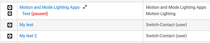

Oh, that’s completely different than the repo I followed from the docs. I installed a sample from the other repo and it gave my two instances.
You can see the two my test instances where I was going for a relationship like the motion and mode app above.
I’ll take a look at that other repo. Thanks.
Ah, I see now you're not looking at devices/drivers, as I had assumed -- Motion Lighting is a child app of Mode and Motion Lighting. ZMC actually does both -- a child app for each instance, and each of those apps creates a child motion sensor device. That last thing is all I was really thinking about in my response above.
