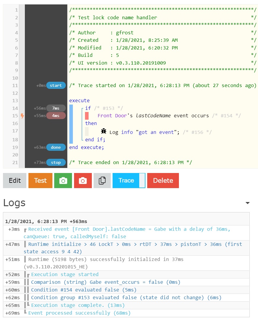

I created a test piston that does exactly what you show (thanks again for sharing the insight), but alas, the code does not execute when I lock/unlock my Schlage locks via keypad codes. I'd paste a screenshot but haven't earned that ability in the forums yet =) I log {$currentEventDevice} and {$currentEventValue} and nada. Tracing shows the event does not occur.

If you read my very last post, I indicated I am running the latest Hub Firmware and the latest WebCore for HE. If your WebCore version is newer than the version I listed, I'd love to know that as it could be I'm off in the weeds and looking at an old repo. Long time WebCore user, so devices must be added otherwise you can't reference them in pistons. I rebooted the hub. I cleared all my browser cache.

Face palm! Full tracing.
@nh.schottfam, any idea why the evaluation of my conditional block (#154) fails? Same thing happens with a virtual device. What version of webCore and Hub firmware are you running?
Install the latest webcore. It has a patch this morning
Voila! After applying the webcore patch released this morning, I can access the value of lastCodeName event. What a ride! Thanks all for the grace you gave me, and your help. I'll post an updated piston that levers this event for extracting the code name. @mike.maxwell, a feature request is to fire this lastCodeName event when the button on the keypad is used to lock the door, rather than just a pin code. It's not happening now. For example, a hard-coded name like KeypadButton. Otherwise, there isn't a single event that can be used to determine lock/unlock via the keypad as the only way to determine keypad lock via (Schlage) button is via parsing the description text from separate lock events.
