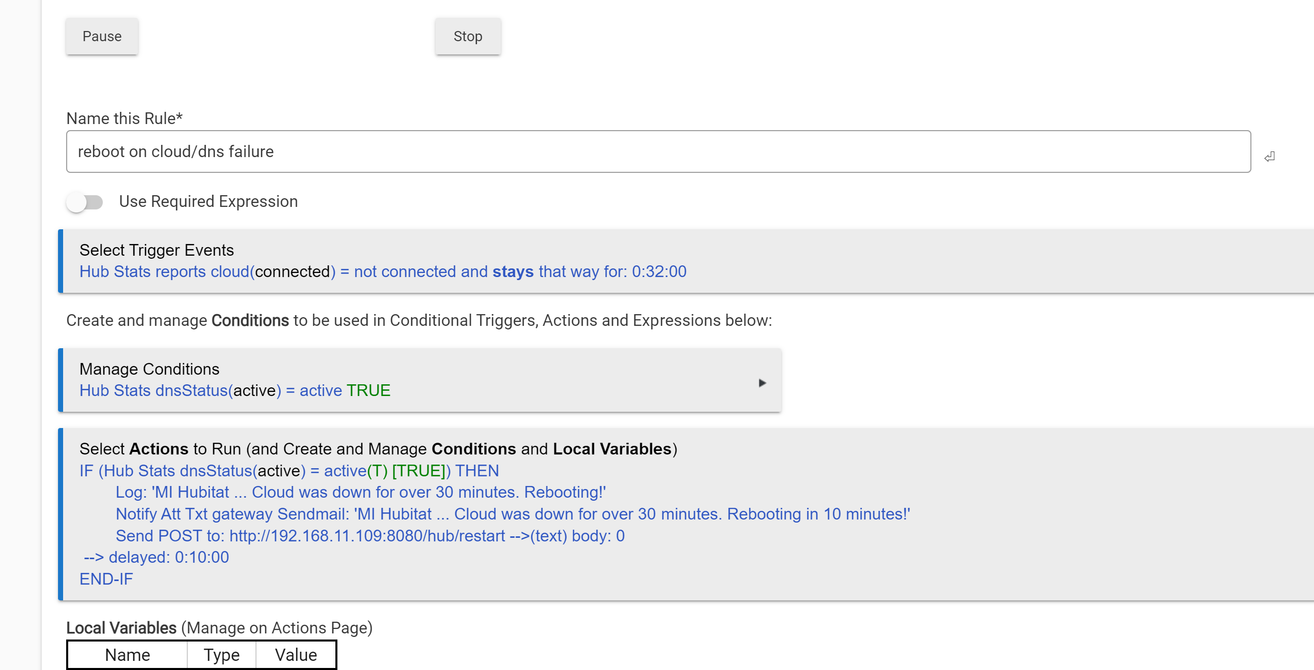

added this as a temporary workaround.. it is annoying like last time i upgraded the router firmware and forgot about the hub reboot and found out 12 hours later...
the 10 minute delay is so i can get a text and determine if it is down for some reason i know about and circumvent the reboot.
