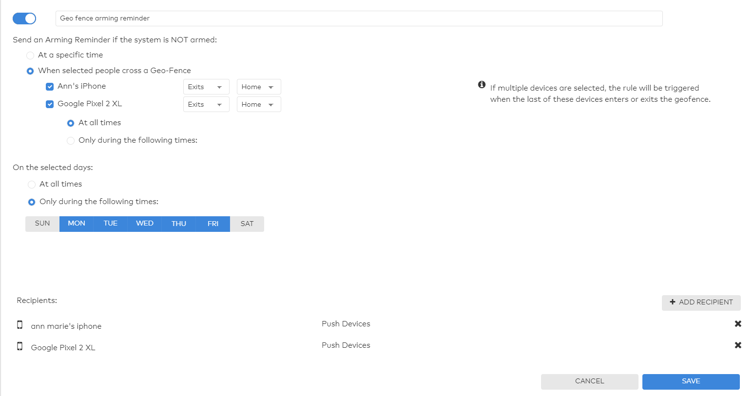

For Example, this is how it looks on Alarm.com
Conditions:
Presence: Pick all phone and then click "ALL" and not present.
Rule, will populate automatically.
Action for true:
  • Notification with delay of x minutes cancel on Truth change.
This won't arm the HSM...you would still have to do that manually.

This gets close, but doesn't send the notification only to the last person to cross the geofence. It sends it to everyone. Any ideas?
The easiest way to do that would be through a triggered rule for each family member. The trigger being that the one person left. The condition being that everyone is gone and then the actions for true of the notification.
