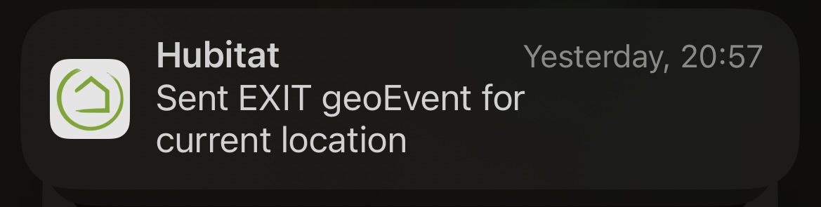

Anyone know why all of the sudden I get these notifications when I enter and leave my house? I would like to turn them off.
in the app go to settings, then turn off ENABLE GEOFENCE.

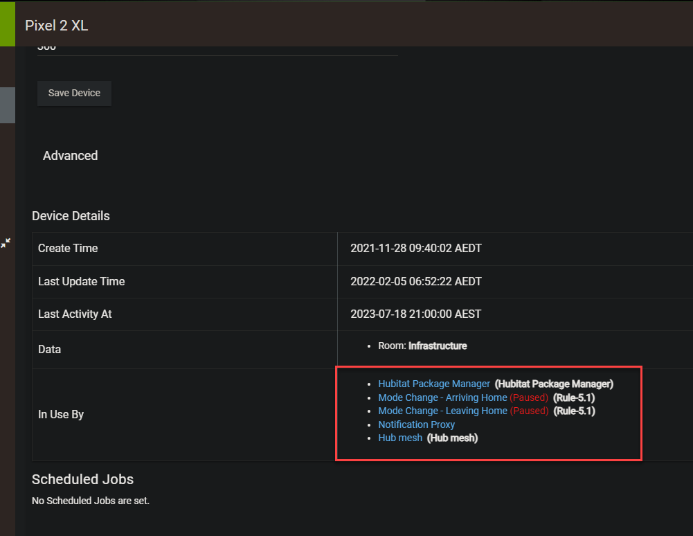

In case it is coming from some rule / app on your hub, you could find the mobile device in the list of devices on the HE web UI, open the Device details page and scroll to the bottom and look at the "In Use By" section to see any places the mobile device has been referenced. If it is an app / rule you have setup to send the notification, it should show up here.
E.g. (I need to set my away rules back up btw):
