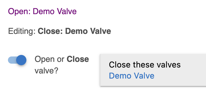

Just tested this with a virtual device, and it indeed appears Rule 5.1 is sending an open() command to the device regardless of which selection you make here:
Tried it both ways, and my device logged open() with either selection (ran it once both ways):

Yes, sorry about that. This was found and fixed for the next release.
