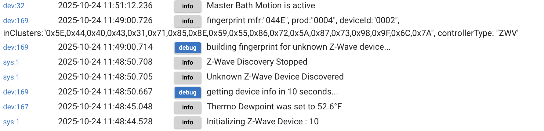

Hi, im integrating an Airzone Aidoo AZAI6ZWUMEL z-wave module for my Mits mini-split. It paired ok but joined as Device, so I guess the fingerprint is not in the database yet. I can provide if needed. I set it to Generic Z-Wave Plus Thermostat, and it seems to be talking. I cant seem to set it to Auto mode. Not sure where the disconnect is with that, but the main issue for me posting is that even with Text Logging and Debug logging enabled, im not getting any logs from the device at all since it paired. Is the driver just not enabled to do any logging? it sure would help to see the activity back and forth to know what's going on with it, ie supported modes might be missing Auto. Thanks.
