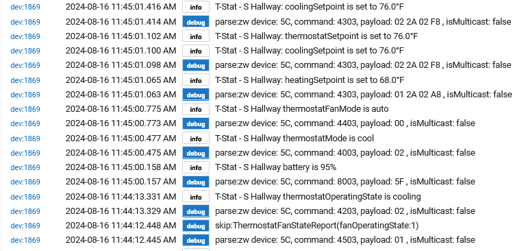

Since I can force fan changes I did that manually to see the values. Looks like the Z-Wave value is ThermostatFanStateReport(fanOperatingState:1) 1 means the fan is running and 0 means the fan is off.
Here is one full cooling cycle

The log entries you provided suggest that the desired information is already available by examining both the thermostatOperatingState and thermostatFanMode attribute values in combination. Is there a case where this doesn't work that I am missing?
