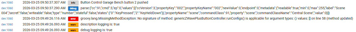

I just installed 2 of the latest versions of the Minoston MR40Z. I have another one that works perfectly with the generic driver. These 2 work except for double tap. It looks like the new ones are using FW 8.1 and the older one is using 8.0.
Working Controller
New Controller

Nevermind. After researching it looks like these are having issues with double tap not working with the 8.1 firmware. Guess I will live without it or replace them with zooz.
