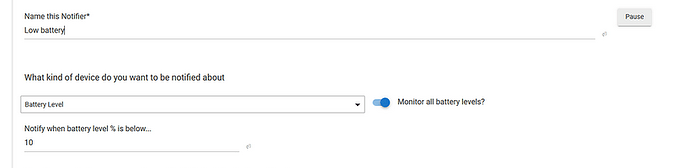

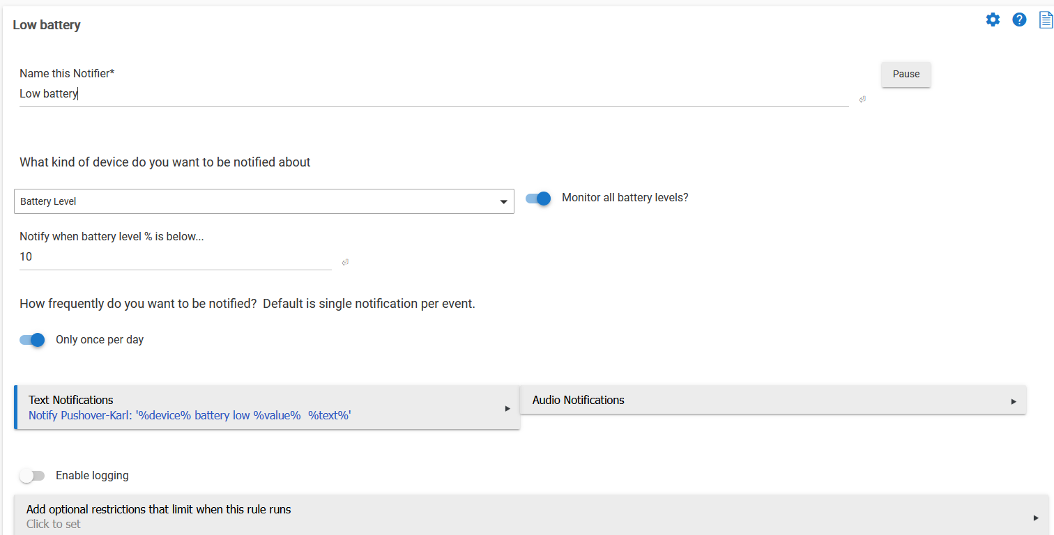

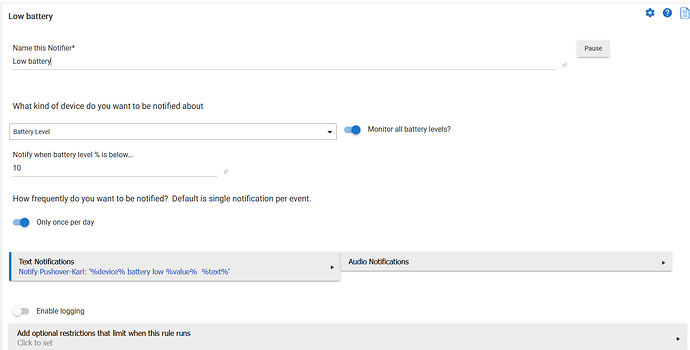

I did the following in 2 minutes with the built in Notifications app.
I have no idea if it really works.

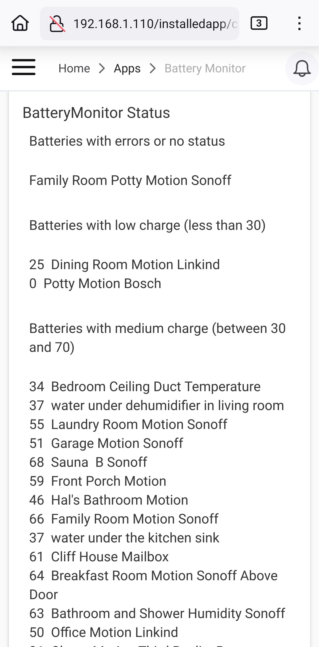

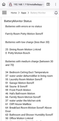

Battery Monitor
Works great for me. The levels can be way off but that is a device level issue, I believe.
Cool app. Thanks for the suggestion. I wish it would automatically look at all devices with batteries rather than require me to manually add a new device at a later date.....oh well. First World Problems.

@velvetfoot FYI that monitor all devices setting will work for all devices at the time you click done within that app. Any new devices added after are not automagically monitored. You would need to go back into that app and clicking done again so that new devices get the app subscription
Nice. I never noticed that option to monitor battery level. Thanks for showing me the option is there!
