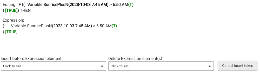

So here's the Expression being edited (y'all have seen this):
I don't want to insert anything, I want to edit the IF ((Variable SunrisePlusN(2023-10-03 7:45 AM) > 6:50 AM(T)) [TRUE]) THEN to something else. Just change the values. How? How do I do this easily? :grimacing: Why isn't there an Edit Expression element that lets me select the part I want to change and just let me change it?

You need to find the Manage Conditions box and edit the original there if you want to change it in all places where the condition is used: Rule 5.1 | Hubitat Documentation. Alternatively, if you want to create a new condition, you can either do so there as well, or the UI provides a way to create one on the fly. You'll have to use Inser before Expression element to put one into your existing IF, then you can use the Delete Expression element(s) option to remove the "old" one you don't want in that expression anymore.
