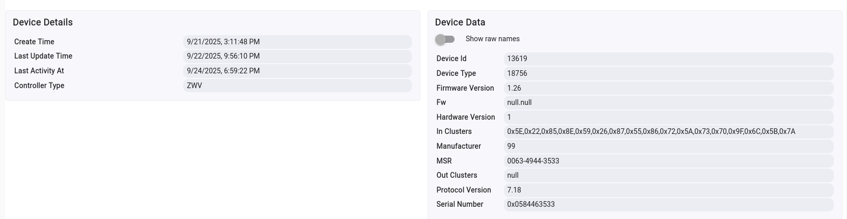

I'm not sure what all data is helpful; but here is the device data of the one showing 3 speeds:

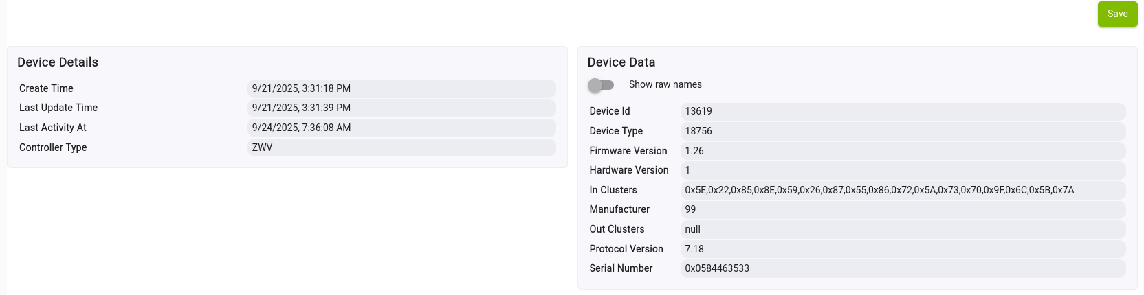

Here is the same for one showing 4 speeds:
Thanks for the details! I don't see any reason one should work and the other not, but maybe it's a browser cache issue. Try a force reload/cacheless reload in your browser if you haven't. It's really only looking for the "Device Id" as you see in the "Device Data" table, and that looks the same for both that you provided -- so I guess really compare that to the ones that are to see if they are the same, too.
