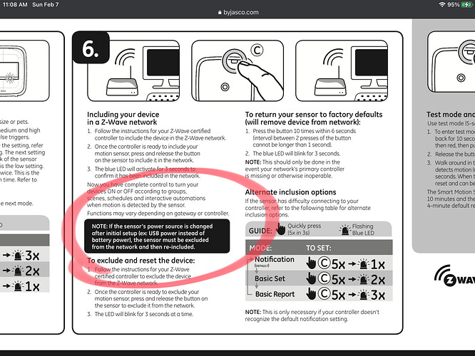

Did you exclude and re-include the device after changing the power type. Documentation mentions this being needed.
I would suggest excluding them, resetting to factory defaults while they are powered the way you want to use them, and re-including them. I donโ€™t have this particular motion sensor, but I do have the Zooz ZSE18, which also can be powered either on battery or from the USB connector. They configure themselves for power type the first time they receive power or when reset to factory defaults. Perhaps your devices are similar.

What I would like to know is where do I find the documentation that said I should do the Exclude and then the re-include when I change from battery power to USB powered?
Again I say thank you - Stu
The fact the role of a Z-wave device on the mesh changes when AC powered vs. battery powered makes sense you need to include again when switching power sources for proper operation.
