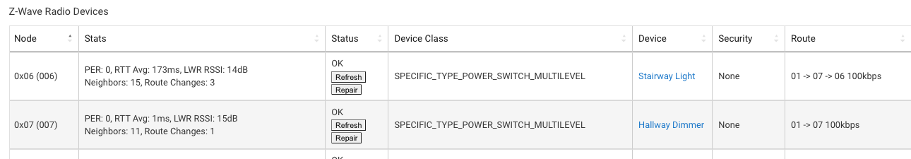

That "Exclude before Include" step has become locked in concrete for me.. An Exclude will NOT cause any down the road problems. An Include can, if it fails, often a "ghost" is produced and they can consume resources and you'll wonder why the hub is running slow. Look at your Settings: ZWave Details page and it should look like this:
Obviously most of those items are specific to MY set of devices, and so the values will be different but you want to see something in each column. If the Device Name and the Route are empty, then you probably have a ghost.
@user5636 Can you post a screen shot of your z-wave details page?
