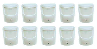

Anyone familiar with these motion sensors and whether or not they work with Hubitat? 10 for $50 seems like a pretty good deal. There’s also a ceiling mount version for $20.

You might want to get some specs on size...seems like this may be more intended for commercial use, where having a small form-factor isn't as big an issue as it can be in homes (WAF/PAF issues tend to arise w/large devices), so they might be large.
I found the specs and yeah, they’re rather large. Good battery life, if accurate, though.
Specifications
  • Dimensions 3.6” W x 2.8” H x 3” D (92mm W x 70mm H x 77mm D)
  • Weight: 94g (without battery
  • Indicators Network LED (green): Network joined; Sensor LED (red): Motion;
  • Controls Utility button: Installation test; Activate device; Reset
  • Trimpot: PIR sensitivity
  • Sensor Coverage 110°, 11 m/36 ft (WOS2-WM-W) 20°, 30 m/98 ft (WOS2-WM-L)
  • Off-delay Timer 30 sec (default
  • 30 sec (software configurable)
  • Radio Properties 2.4 GHz +7dBm transmit power
  • Operating Environment 14°F to +122°F (-10°C to 50°C) Indoor use only
  • Mounting (2) Screw holes on swivel mounting bracket; wall (or ceiling) mount
  • Compliance US: FCC Part 15B, FCC ID (NRH-ZB-Z100B) Canada: ICES/NMB-003 Class B, IC ID (8984A-Z100B)
  • Power Supply (2) AA 3.6V Lithium-thionyl chloride battery (included)
  • Battery Life 5 Years (normal operation)
  • Warranty 5 Year
