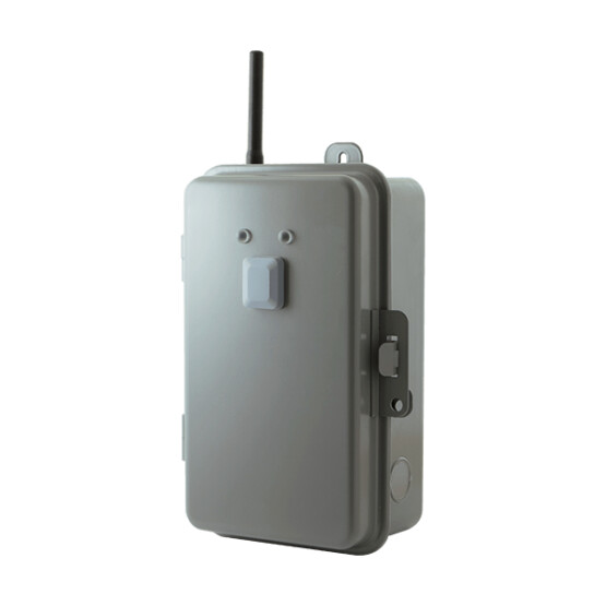

GE 14285 I/O 40 amp Smart Switch - only turns on in close proximity with switch door open
Installed the GE/JASCO 14285 40am indoor/outdoor switch into Hubitat. Trying to run a simple automation to turn on/off pool light at sunset/set time. Can't get it to perform.
The Hubitat is physically connected to my WIFI router. The GE/Jasco switch is about 35 ft away (2 rooms in the house and then outside of a window from the hub).
Using the device profile in the Hubitat app, I have tried to simply turn the switch on and off as a test with the following observations.
  • From inside my home, it wont do either
  • From about 10 feet up until right next to the switch, OFF works, but ON will not
  • When I open the door to the switch, then both OFF and ON work.
Why would OFF work but ON does not in most situations until the switch door is left open? Obviously, it is outdoors so leaving the door open is not an option.
Any thoughts or help would be greatly appreciated.
Thank you,
Eric
