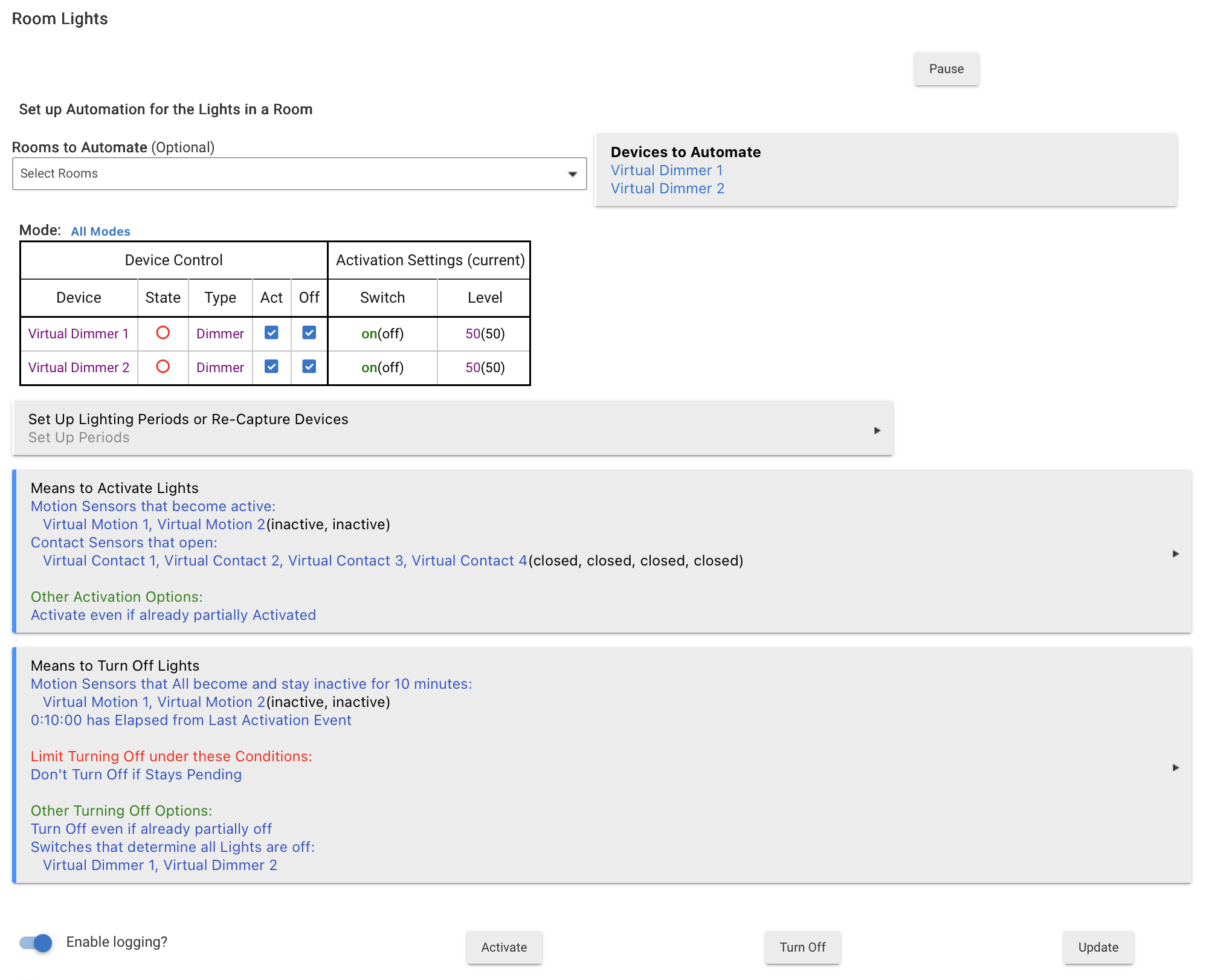

Here's a RL rule.
  • Only difference from OP scenario is to add an off timer that will turn off the lights after 10 mins if a door is opened and a motion sensor is not triggered. The "don't turn off if stays pending" keeps any active motion sensors in charge of turning off the lights as the motion off trigger will always be >10 mins (due to hardware timeouts) in this example.
  • I usually add options to turn on/off if partially (1 of the 2 lights in this example) on/off
  • I usually add all the lights to "switches that determine all lights are off". It's a bit of belt & suspenders for simpler rules, necessary if one is using buttons instead of lights.
These rules become easier to implement as one gains experience.

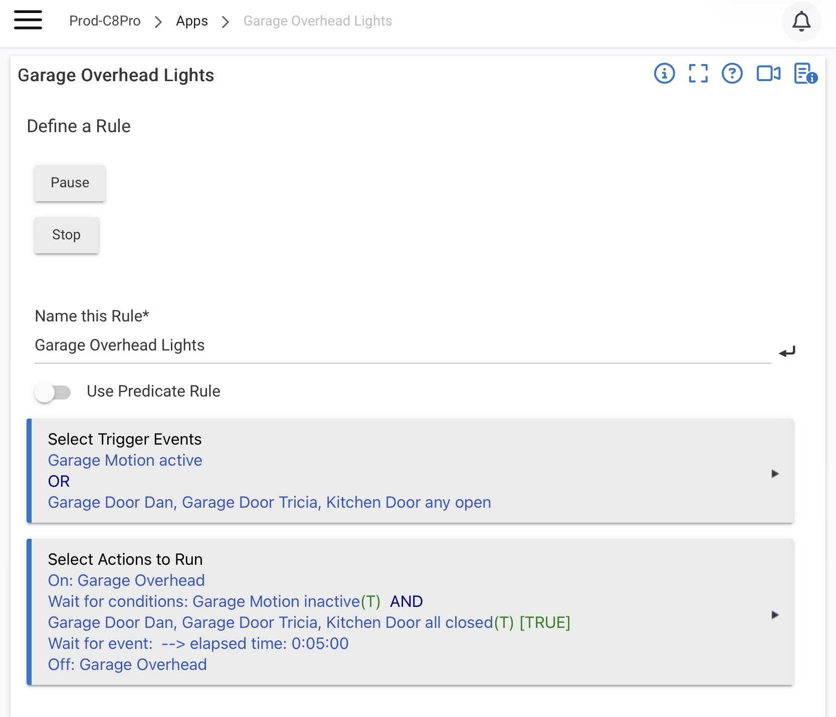

Here is my garage lights Rule Machine rule that has worked extremely well for years.
