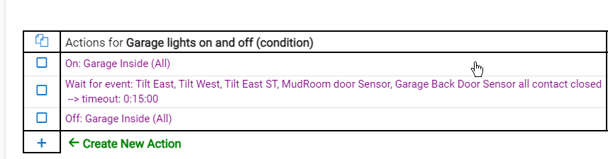

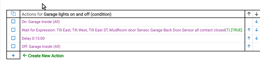

this is what I have
BUT? should have I done it this way?
i can keep the garage door open for more then 15 min, but the lights will turn themselves off, even if the door is open
I think this is what I might have missed?
i have not had time to test it yet.
@eaton.blumenstein You don't want to use Delay, you want to use

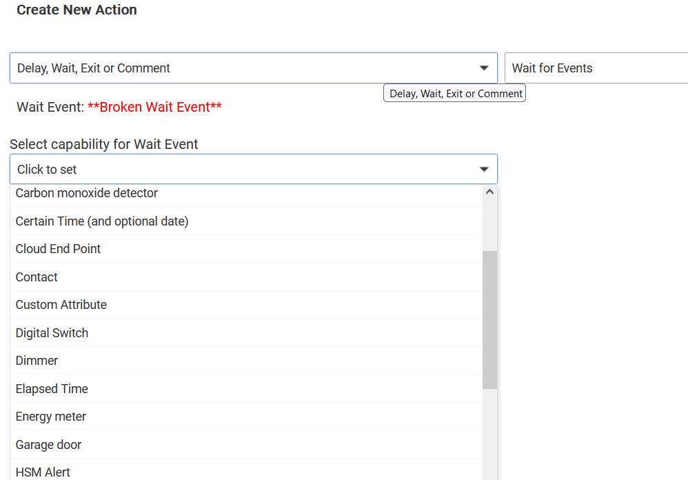

Wait for events...4th in the list
but do i do this, and then set the 15 min like this?, or do i do a delay action after?
When you add the Wait for Events then go to Select capability you'll see the option for Elapsed Time
You could add a 15 minute duration to the Wait for Expression (not timeout) and get the same result in one action as the suggested Wait for Expression and Wait for Event together.
Note that duration defines how long the expression needs to be met or true before moving to the next action. Timeout defines how long for the Wait remains in the false state before moving to the next action.
For example:
Wait for Expression: Tile East contact closed --> duration: 0:15:00
The contact must remained closed for 15 minutes for this action to be met and move to the next action
Wait for Expression: Tile East contact closed --> timeout: 0:15:00
The action will be met and move to the next action when the contact is closed or it's been waiting 15 minutes for the contact to be closed.
And for this rule, lines 1, 2, and 4 are fine. Just need to replace line three with a wait, not a delay.

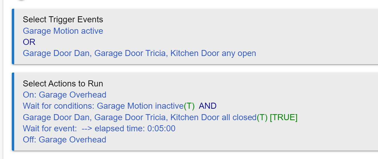

Here is my rule for Garage Lights. It has been working great for a very long time.
