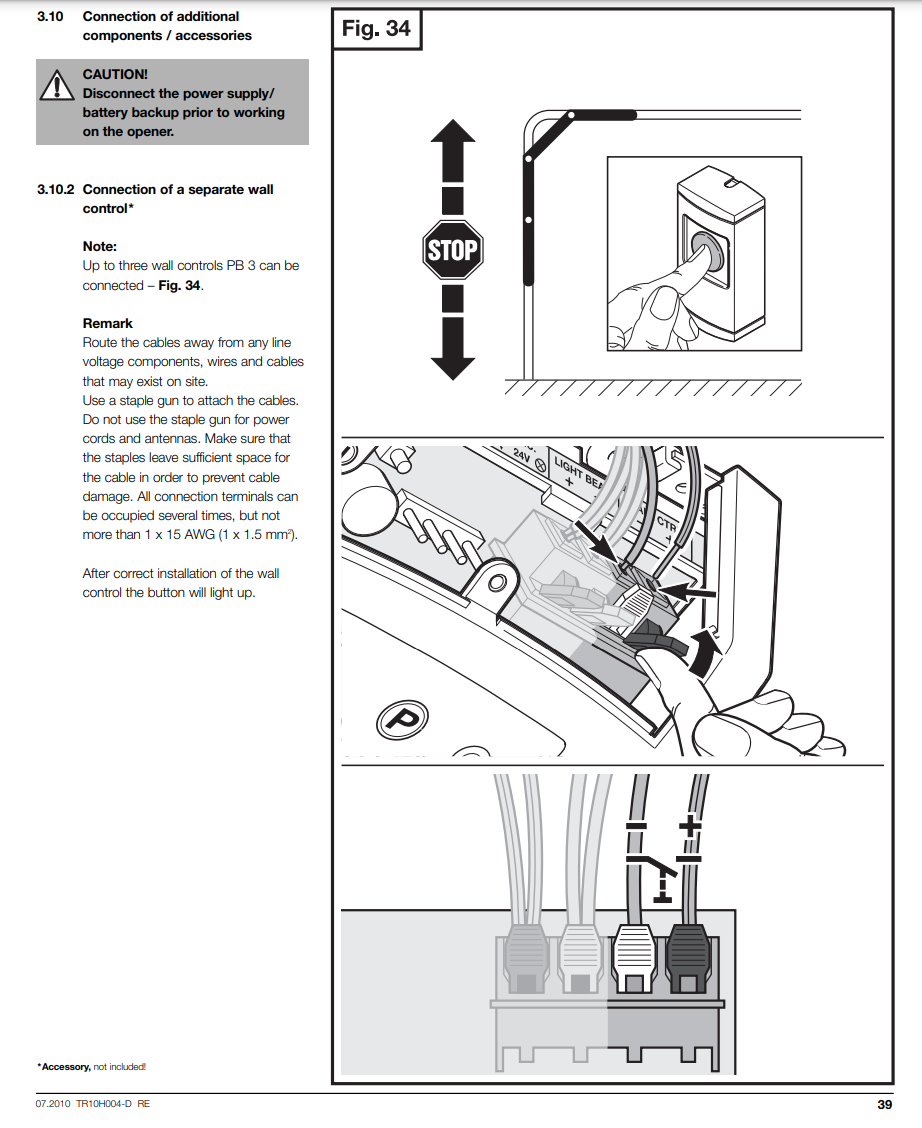

It looks like it's capable of having a simple dry contact connected to the controller.
Edit: Maybe not, seems like more than a pushbutton:
  • Light and lockout controls
