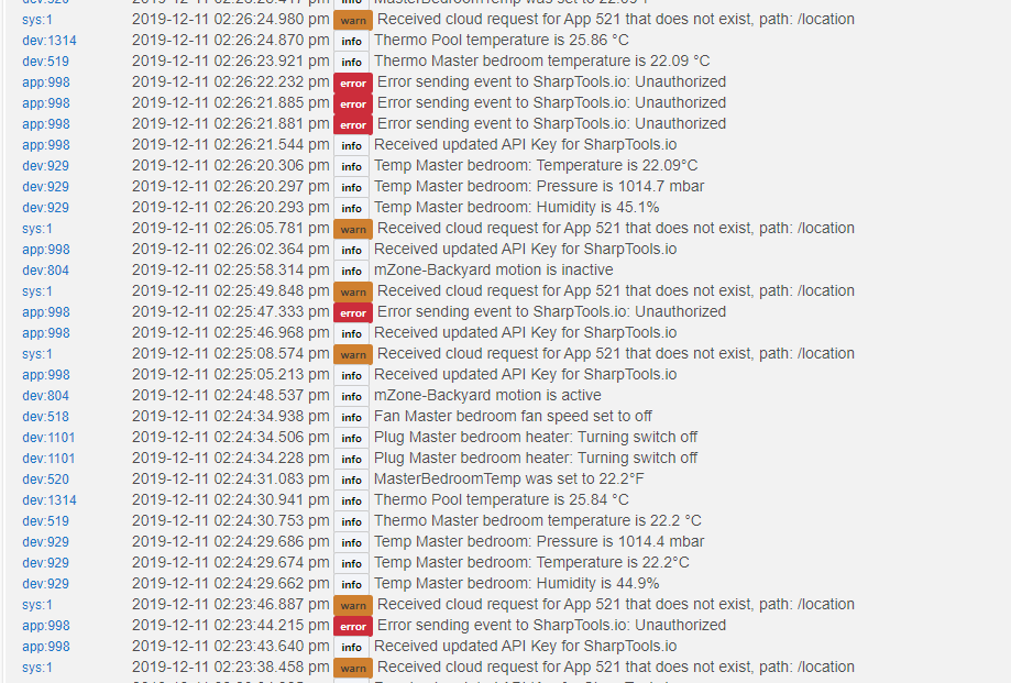

Hi guys, I have the same error in my hubitat logs, "Error sending event to SharpTools.io: Unauthorized"
It's happening randomly around every 10 mins
i tried to Authorize using Sharptools website and the hubitat app multiple times with no luck
Please note i have 200+ devices and most of them synced to sharptools.
Can i remove Sharptools app from hubitat and re-add again without affecting my current dashboards?
Yes.
You might start by rebooting your Hubitat hub, then waiting several minutes for it to boot back up and everything to calm down. Then try reauthorizing starting from your SharpTools.io User Page
Feel free to send a note to support@sharptools.io and we would be happy to help.
The logs look like you're getting a new API Key periodically. Almost like the authorization process isn't fully completing. If you shoot a note to support@sharptools.io I'm sure we can get things sorted out! :smiley:
Thanks for the prompt reply Josh, I'll remove and re-add again and if any issues then will raise the note.
