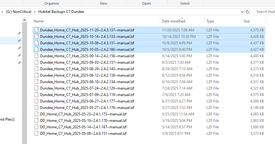

I'm thinking 10/5 2.4.2.160 - a good choice? Below are my options:

Also note that restoring a backup doesn't roll back the firmware - that needs to be done from the Diagnostics menu.
thanks for the reminder on that about the firmware. I remembered a little about this this morning - I started having problem on DST, and things haven't solidified since. I'll go back and hand fix things next chance I get.
