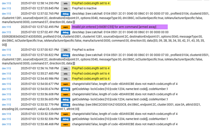

  • Put a new fob on the keypad then checked the logs. Does not show the code of the fob.

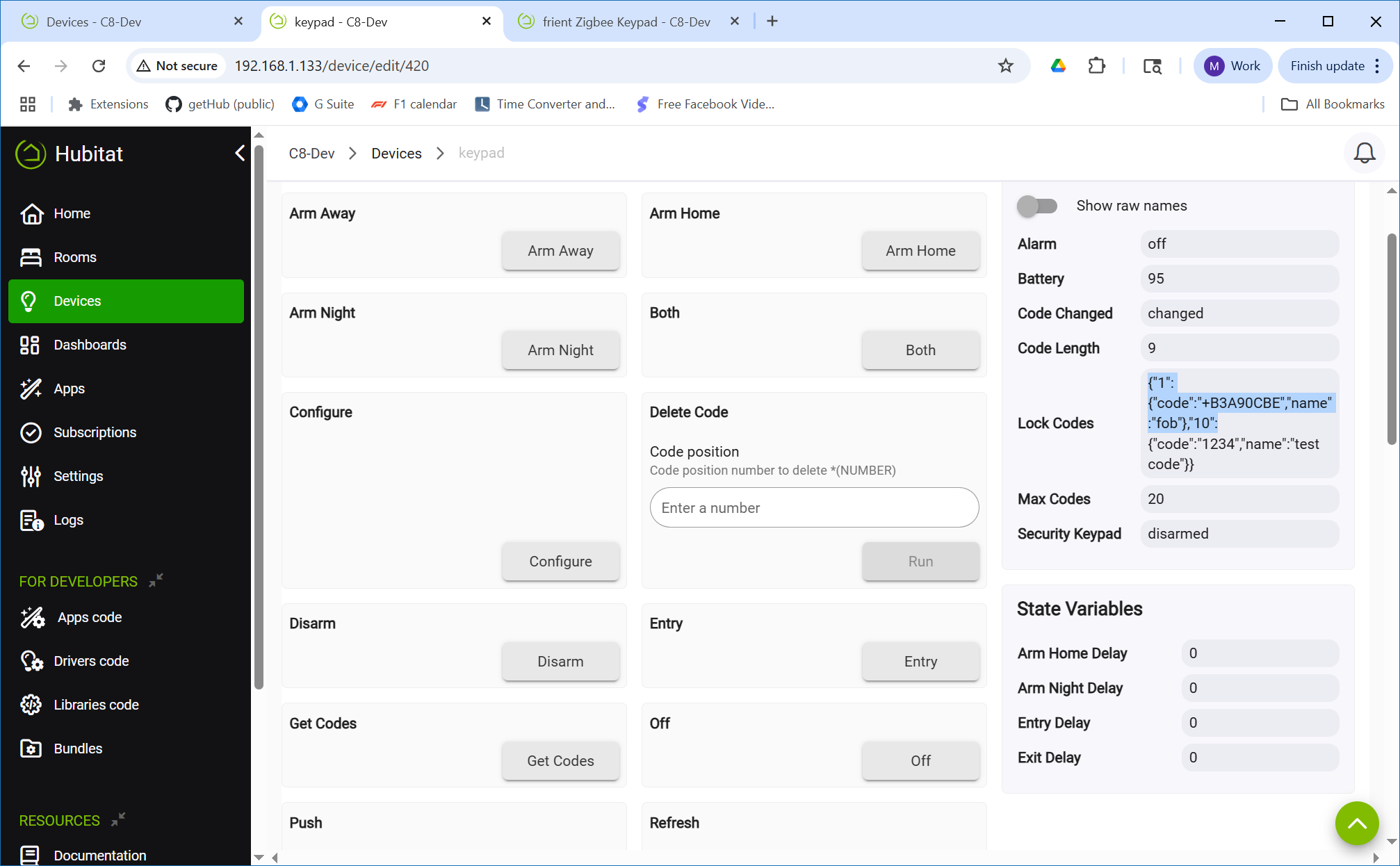

  • Put the new fob on the keypad and then hit armed. Shows a string code with length 9.
  • I tried to set the maximum code length higher than the default 4, but at the moment when I set it to something like 10 the logs show it set to 4. So at the moment I am unable to attempt to use this technique to grab the fob code and enter it manually into lock code manager to see if it will work.
I assume that if I can get the length expanded the fobs will work. It may be that there is some issue with changing the max length of the code from 4 to anything else. Can you take a look?
Yellow highlight is what I get when I try to set the code length to 10. Purple is where I have grabbed the fob code as shown the logs and added it to lock manager and then tried to use it to arm.
Awesome!, the code came through!, I'll have a look at why set code length won't take 10

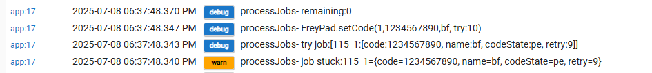

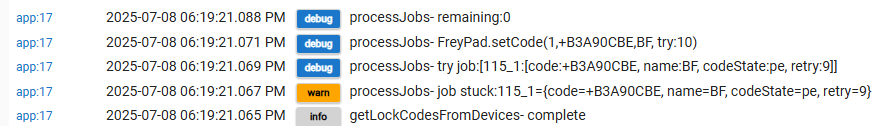

@mike.maxwell So some good news and some bad news. I was able to set the code length greater than 4. However, I think the problem is now setting the value of the code in lock manager, or I am doing something wrong.
I try to set the code, but logs show the job is stuck and it retries the 10 times and then fails. Interestingly, the log lines are updated while retrying rather than a line for each try. I have never noticed that behavior before. Weird.
Could it be that lock manager doesn't permit non numeric lock codes?
I also tried to add it on the device details set code option. It didn't do anything and nothing in the logs.
Let me know what you want me to do or test out etc.
I tried to do a 10 number code and it failed so its probably not an alpha issue.
Try setting it directly in the driver, see if that works first.
Mike, yes I mentioned that above. It didn't seem to do anything. No log messages.
Found another issue we're not adding a code if the length of the code doesn't match the maxCode setting, a legacy setting from other zigbee keypads which only worked with a 4 digit code.

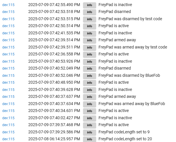

I'll update the driver to fix this, in the mean time if you set the code length to 9, you should be able to add the code.
Nice. I can confirm this works if the max is the actual length of the code you want to add. I can also confirm the existing test code with length of 4 still works.
