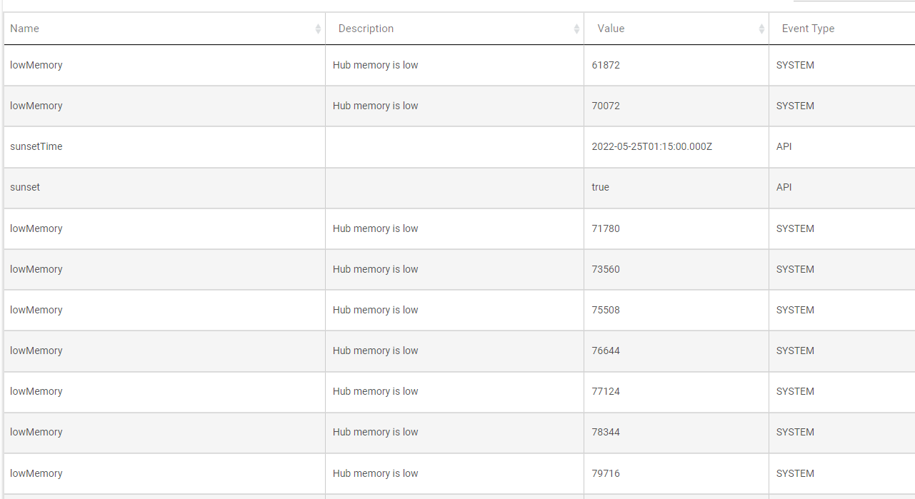

Found this message in the location events on my development hub and can't understand why it's giving this. When the hub was running things at my mom's house never saw it:
Frequent network drops detected
Also the low memory warning is on the alert area and all I have done with this hub is stand up hub mesh from my primary hub and try to bring some devices over.
Seems like there is a memory leak but no way of knowing where it is.
Probably should reboot and then look, 62K is the lowest value I’ve seen in a hub that is still running.
