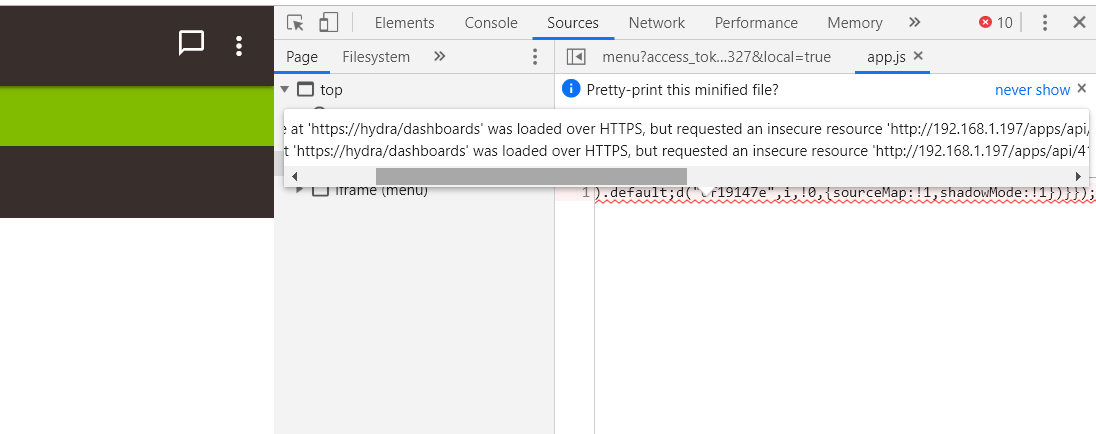

If you assign a domain name to HE and access it via TLS, the icons in the dashboards app reference the non-TLS page at its regular IP address instead of the address and protocol you used to log in. Since this is a security violation, modern browsers won't allow you to click on the icons to open your dashboard. Workaround is to use cloud dashboards.

Hmm...either Safari considers excepted self-signed certificates to be secure, or you've added the site to some kind of trust zone (or you've figured out how to load your own CA certs to hubitat, and if so, mind sharing how?) That does leave me wondering if Safari won't automatically prevent loading mixed content (IE doesn't, but nobody really uses it anymore.) At any rate, this is what I'm seeing on my end in the Chrome debug console:

That might be why. Can you open the debug console and see where that particular iframe is sourced from?
Yup. hubitat.aiyar.net

Odd, I wonder why mine is doing this. I initially set it up over non-TLS with just an IP, I wonder if it stores that information into a configuration file somewhere when you first set it up and then it keeps using that information to make self references?
EDIT: When you access yours over plain HTTP and click one of those, does it point back to the HTTPS version?
No. And to be clear - the first time I accessed the hub using https in Safari was today. I do routinely use https in curl - for nightly backups and other functions.
