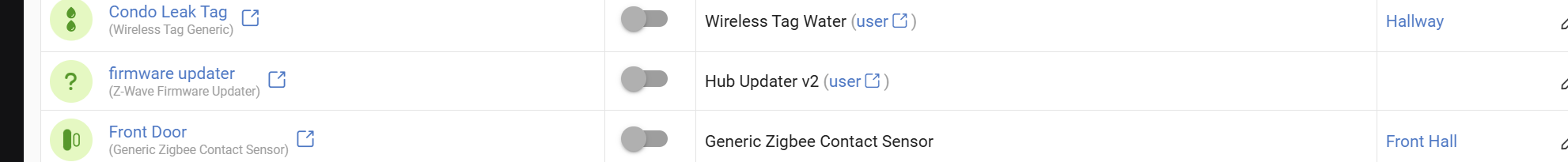

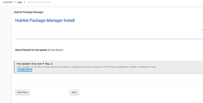

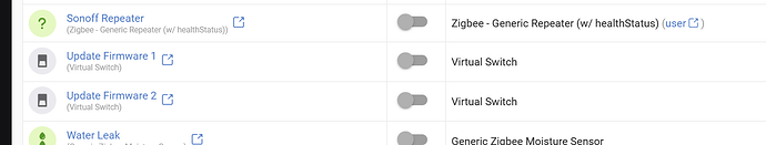

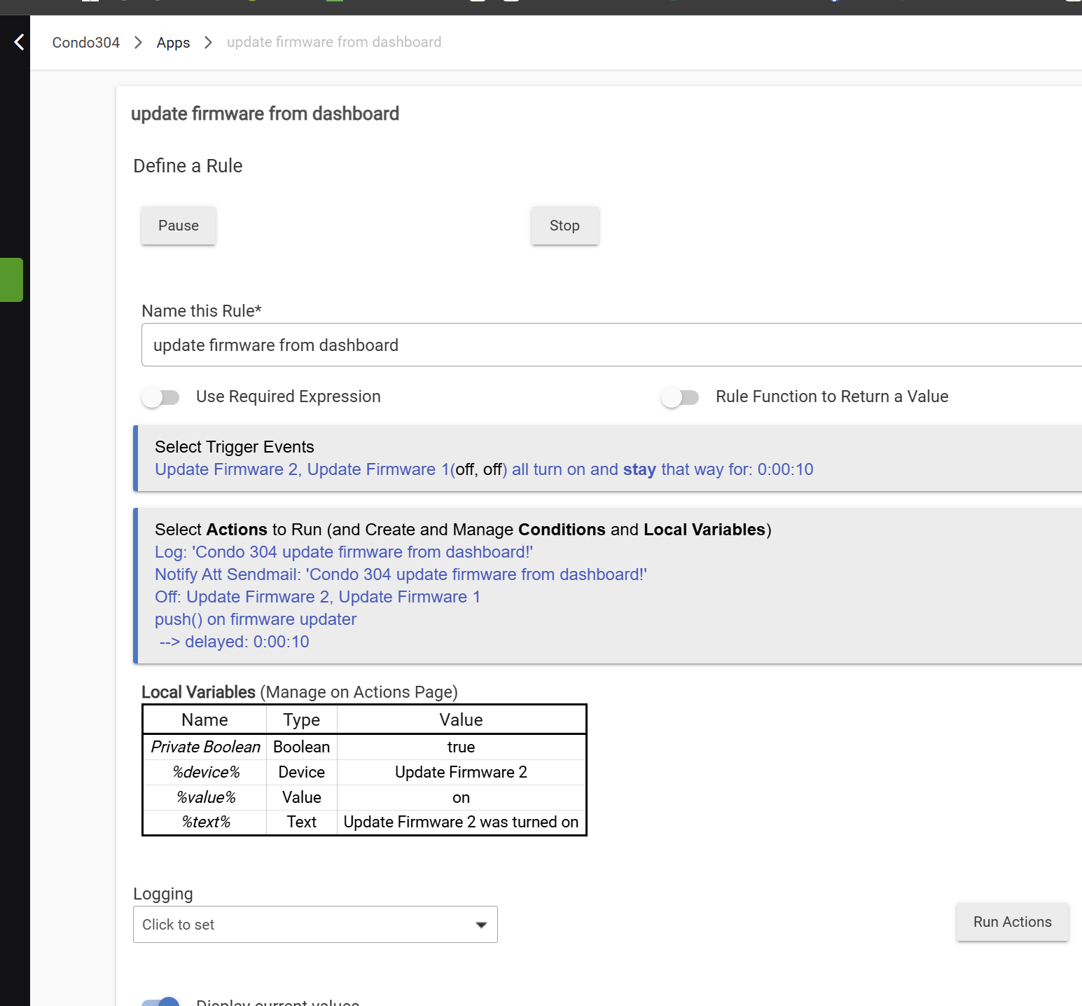

i have 4 in various locations and use this method to simply push two buttons on a cloud dashboard for each to kick off the fimware update..
Within 1 minute i can kick off the firmware update process on all my hubs.
The dual buttons is just a safeguard against accidentially clicking one button when using the dashboard.

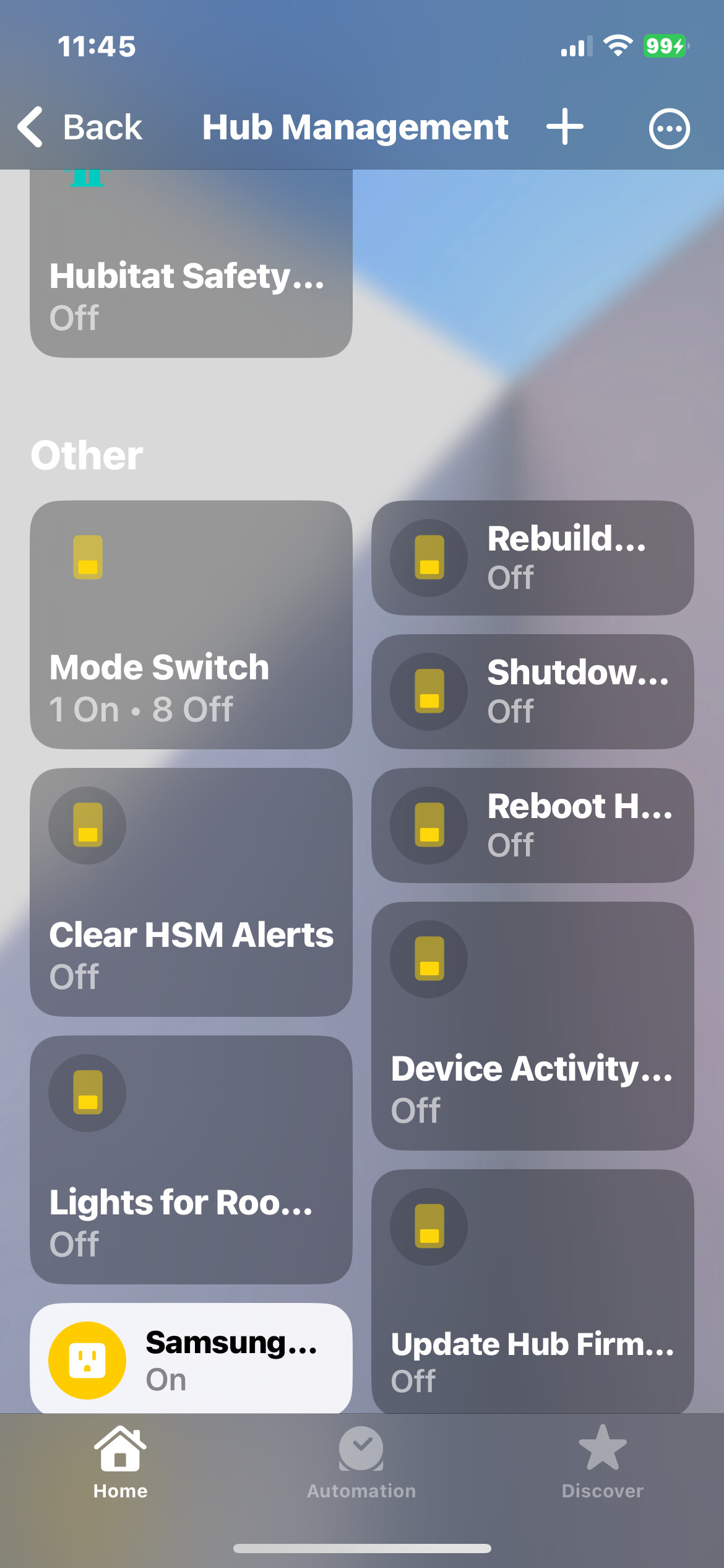

I have also recently decided to make updating, rebooting , rebuilding databases, or shutting down 3 hubs more efficient.
