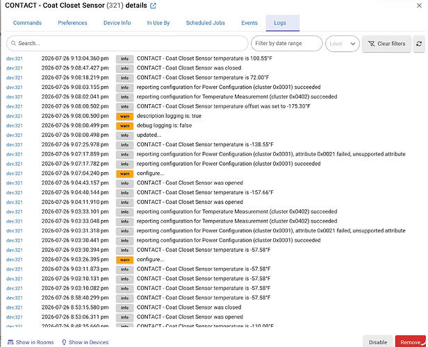

I have a number of Iris V3 contact sensors that are exhibiting strange temp reporting and swinging wildly. If I provide a reference temperature, it still doesn’t help lock down the number, just gives a different point to swing around. Running 2.5.0.159, tried changing to a different driver and then back, no change. Tried re-pairing device, no change. Only about half of my devices are doing this and seemingly recently, perhaps in the last few weeks. Might correspond with the last firmware update, but not entirely sure. These have been working fine for over a year.
Anyone else seeing this problem and/or have suggestions. Snapshot of logs attached.

Battery changed again to confirm. No change in operation.
