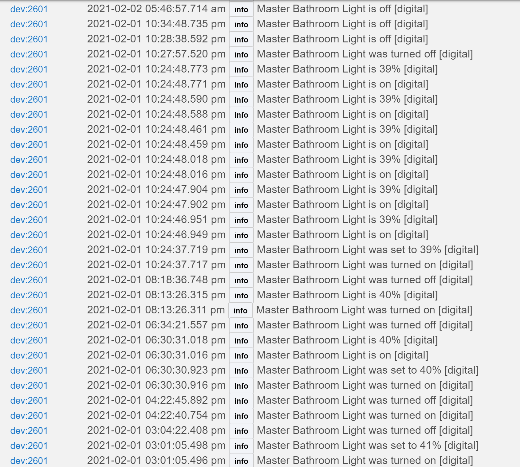

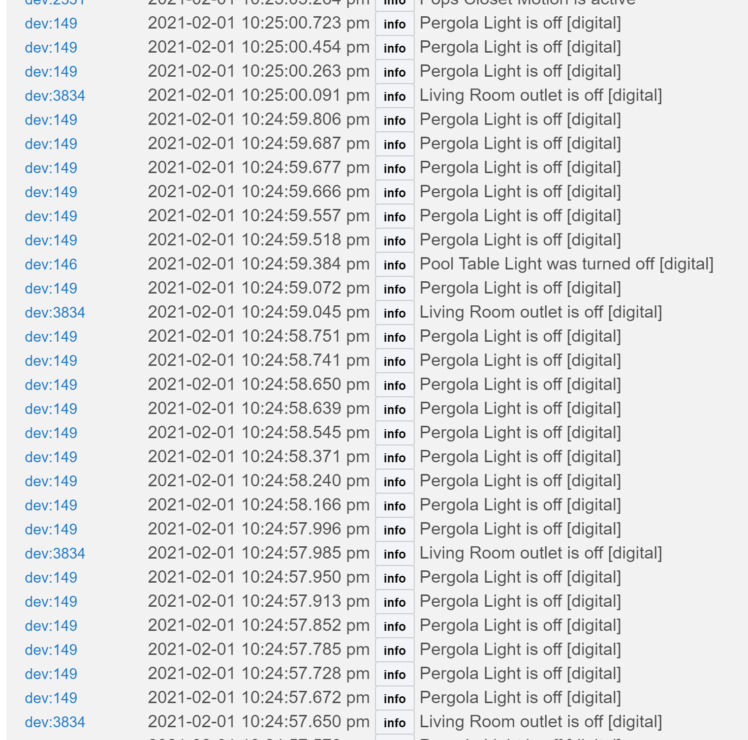

I have several z-wave (plus and non-plus) devices flooding my logs
GE Z-Wave
Here is a z-wave plus, I think it's a Go Control
C-3 running 2.2.5.126
Don't recall seeing this in the past, not sure when it started
Thoughts?
Thought? Yoyu are getting massive re-tries on your zwave devices/mesh. Either because:
  • Bad device
  • Poor signal quality - not enough repeaters, too far apart, or interference
  • Hub is gummed up and not getting acks out fast enough
1st step is to shutdown hub from interface, unplug power for 30s, and power back up to completely reboot/power cycle the hub.
If it keeps doing it, see #1 and #2 above.
Maybe you lost one of your repeater devices? Or a bad switch? Those GE are getting to the age where they seem to by dying for a lot of people.
I rebooted this morning and the logs have settled down, must have been Hub related. I have a few repeaters and they are all online and no issues with any devices, just this logging...

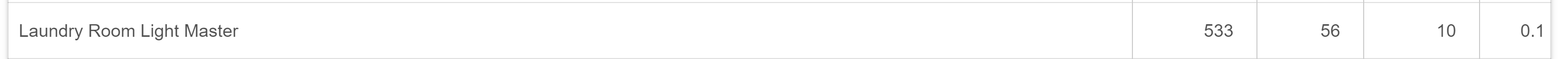

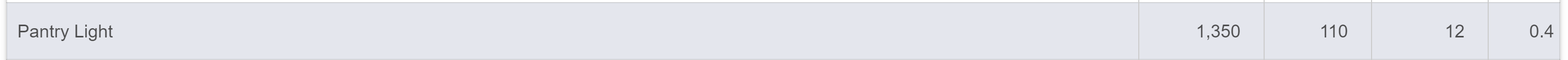

The device that I posted above is a Z-Wave plus (GoControl) switch and is literally 3' from the hub, and there are 2 repeaters in the same laundry room (dryer and washer) so unless the device is routing out and back in, can't see how it's a mesh issue
The device stats seem to be OK, no long delays
Another switch (GE Z-Wave Plus) is 8' from the hub
Am I not reading the device stats correctly?
