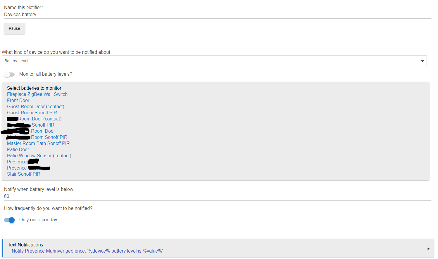

@gopher.ny I have some drivers that are sending battery values as decimals it seems. This is breaking the the notifications which probably is expecting an integer as the battery %.
Thanks for looking.
app:33452021-05-11 10:22:24.198 am errorjava.lang.NumberFormatException: For input string: "72.5" on line 419 (batteryHandler)
