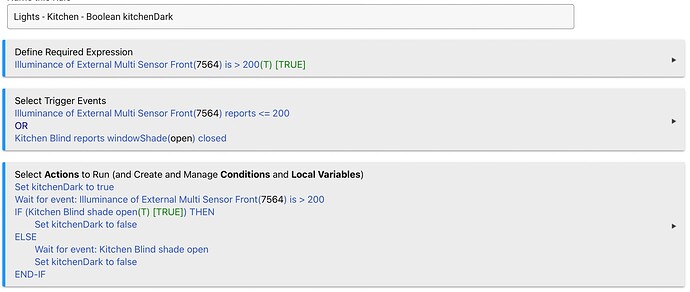

I can't figure why this rule didn't work this morning. An identical rule for an adjacent room worked as expected. It flips a boolean to true when the lux falls below 200 or the blind closes, waits for the lux to go above 200 and flips it false, unless the blind is still closed, in which case it waits for the blind to open before flipping it false:

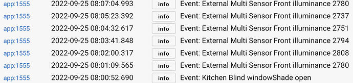

The log shows that the blind was closed and the rule was waiting for it to open. Later, the log shows the blind open:
However, the rule does not complete. The wait is over, the blind has reported open, it should proceed to set the boolean false but nothing happens.

There are two waits. Once the boolean goes true, it waits for the lux to reach 200. IF the blind is open the action sets it false, ELSE it waits until the blind is open then sets it false.
It did, it's shown here - Else, Wait
The event then occurs - the blind opened and reported open at 08:00:52, so that wait for event was over, yet it failed to complete the actions.
Well that's exactly what this rule already is. This rule flips kitchenDark true when the curtain closes or the lux falls below 200 externally and false when the lux rises above 200 externally so long as the blind is also open. I'm then using that boolean as a required expression in my Kitchen motion lighting rule.
If I am reading that right your first problem is the required expression. It requires the illuminance to be greater than 200 to trigger. So the trigger of <= 200 can never trigger the rule.
So when the illuminance is > 200 and the blind closes is the only available trigger for the rule.

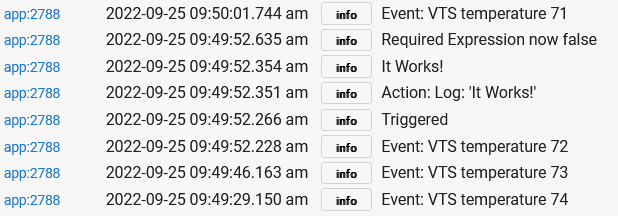

It works. It allows the rule to trigger when a threshold is crossed but prevents the rule from re-triggering whith subsequent events below the threshold. Here's an example that shows the Required Expression is evaluated after the Triggering event happens.

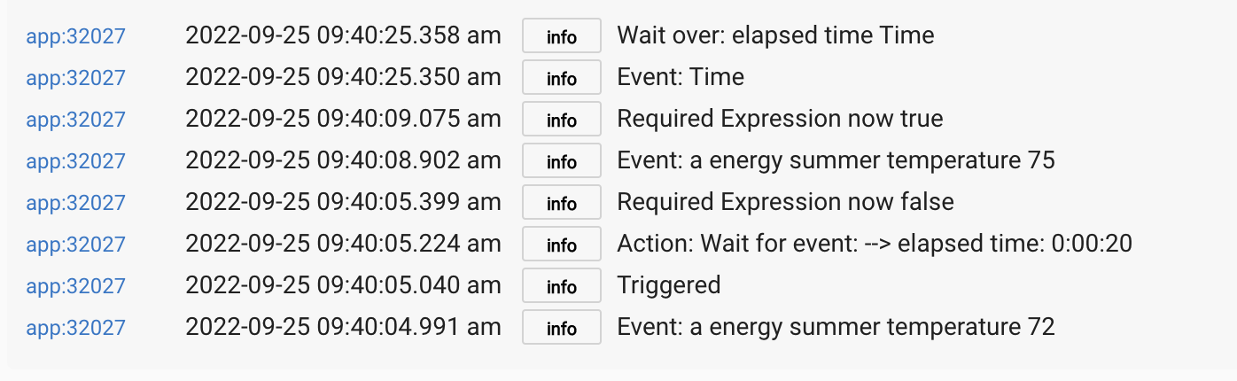

Agreed but I just replicated with this simple rule.
@bravenel The rule triggers and if the Required Expression stays false, the Wait executes properly.
If the Required Expression goes back to true during the Wait, the Wait fails to execute.

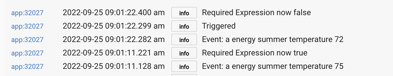

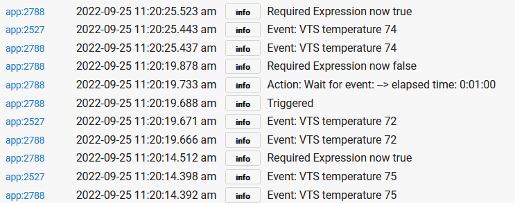

Please consider this log, from a rule with the same Required Expression and Trigger as yours:
At the moment the temperature sensor first reports 72, the Required Expression is true from the previous events. Consequently, the rule is triggered, and then the Required Expression becomes false. This is exactly how it is supposed to work.

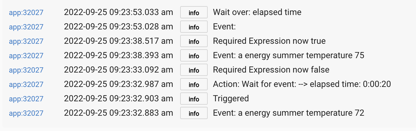

@bravenel Yes, I understand that. The issue is different. If the Required Expression re-evaluates as true during the Wait, the Wait fails to execute.
Yep, I see that. Will fix it.
I love it when I report a bug and it turns out to be a bug.....rather than something I've completely misunderstood or cocked up :smile:
Fixed, but for a spurious log entry "Event: "
