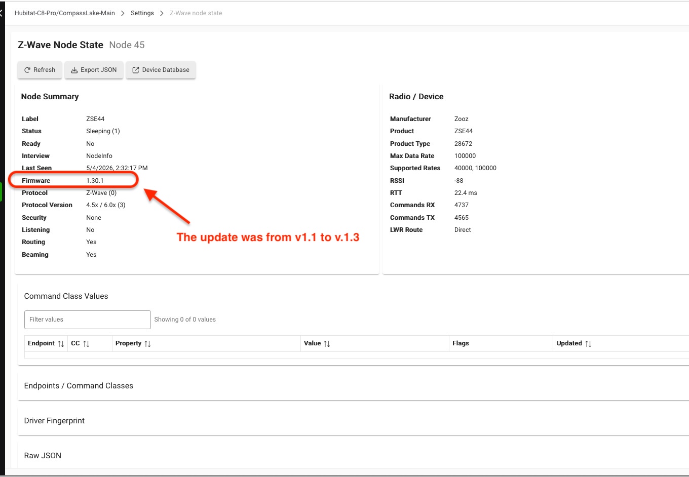

As I said earlier, how about going to the Z-Wave settings page and click on "State" for that device?
I had checked it before and just checked again and guess what it shows?
The new firmware. However, that is not shown from the Device Info tab under devices. Perhaps it'll fix itself after a while. See the screenshot.
Maybe in a while. Maybe not. :grin:

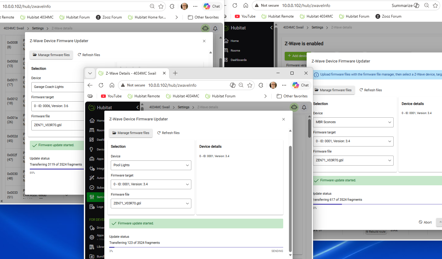

I was complaining a while ago about how laborious it was to firmware update several like kind devices. Having to wait for one before doing the next.
As it turns out you can do a few simultaneously. Just open separate windows to ZWave details and then open the firmware updater and you can have several simultaneous sessions. It just never occurred to me this would work, but it works just fine and takes away some of the wait time when you have a few devices to do.. Queue up a few and go grab a coffee and come back later...
I stopped at three session but I don't see why you couldn't do a few more. Anyway I think that's a nice discovery that could be a time saver for some.
